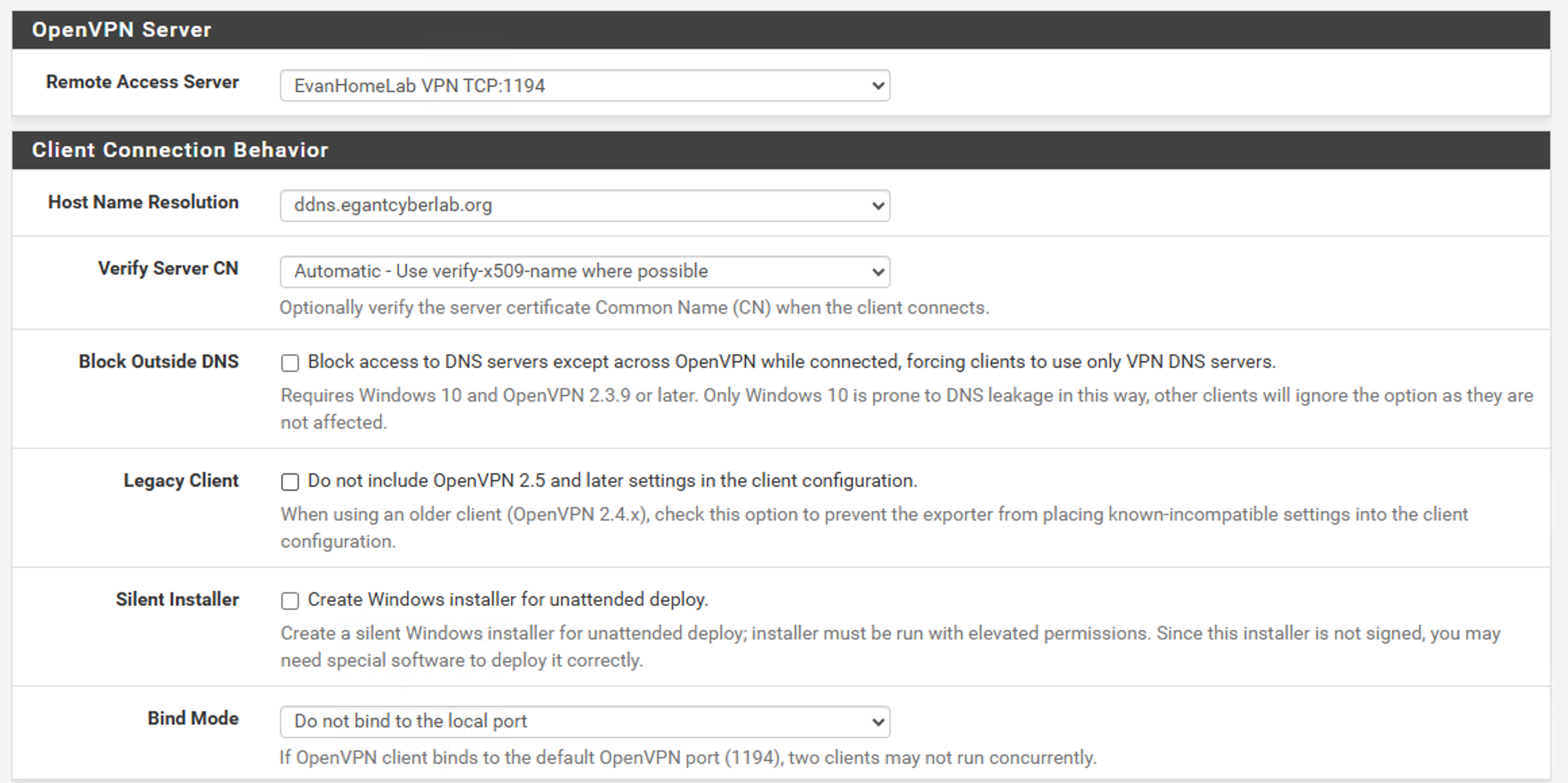

      I'm new to pfSense and having trouble getting OpenVPN to work outside my network. Here’s what I’ve done so far:
      OpenVPN works perfectly when connecting via the LAN using the internal interface.
      I registered my public IP with a DDNS hostname through Cloudflare for external access.
      The issue: When I try to connect from outside the network, I get stuck at "Attempting to establish TCP connection with AF_INET:1194."
      Any suggestions on what might be causing this or what I could check next?
      Thanks in advance for your help!

        johnpoz LAYER 8 Global Moderator @evang
        @evang is it not resolving that ddns name you gave.. The client doesn't give an IP its trying to connect too just
        "Attempting to establish TCP connection with AF_INET:1194"
        There should be an IP there. Your public IP.. And you would need firewall rule to allow it on your wan. If you ran through the wizard to setup openvpn that rule should of been auto created... Do you have any rules above it that would be blocking your source IP? Or rules in floating that would?

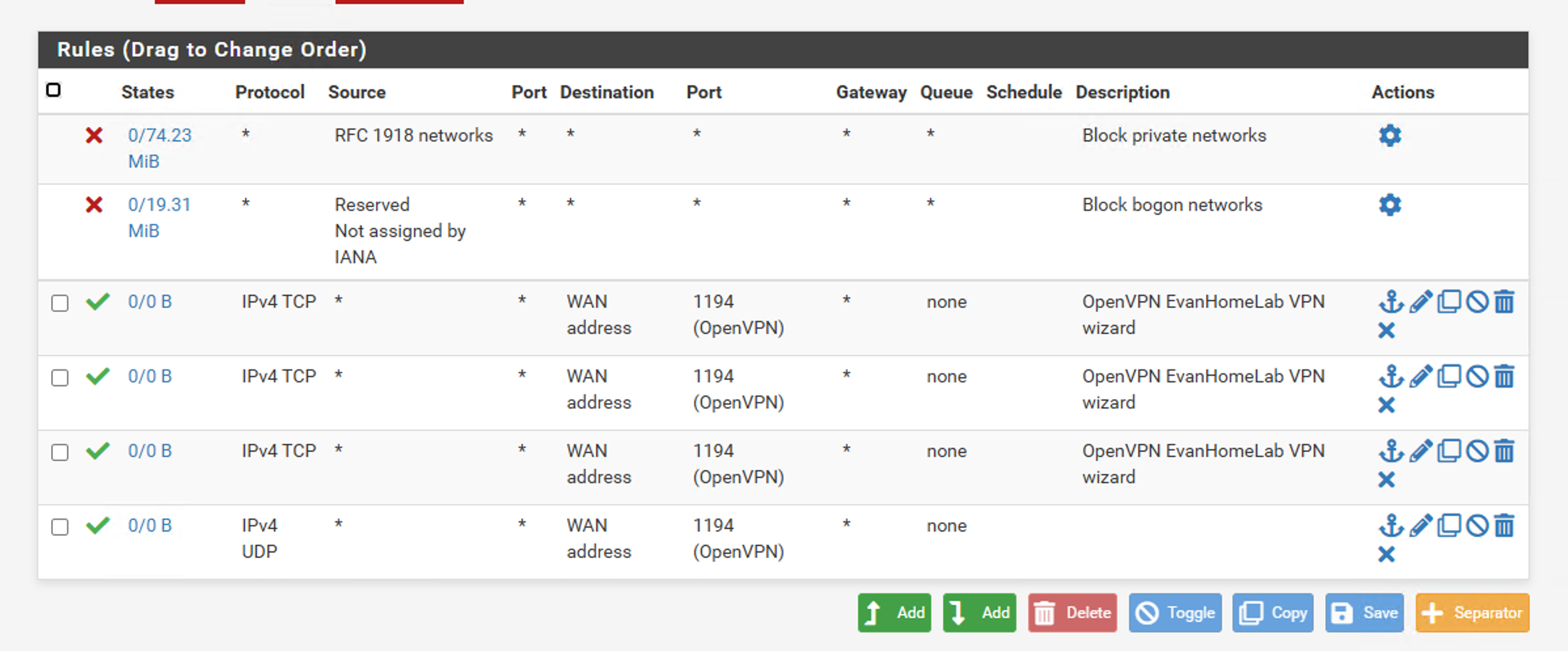

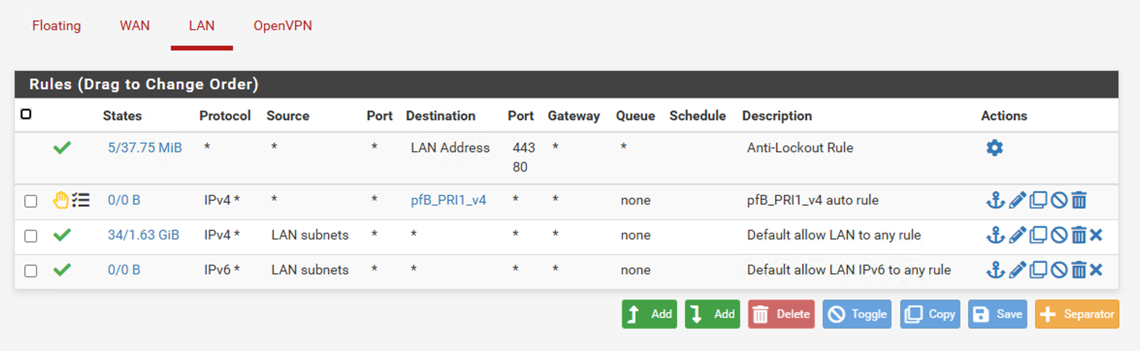

          Here are my current rules
          Screenshot 2024-10-05 at 11.07.00 AM.png Screenshot 2024-10-05 at 11.07.10 AM.png Screenshot 2024-10-05 at 11.07.30 AM.png Screenshot 2024-10-05 at 11.07.41 AM.png
          The log entry I provided did have a public IP I just chose to not include it for security reasons
          Attempting to establish TCP connection with [AF_INET]my-public-ip:1194
            @evang well looks like you ran through the wizard a few times - see multiple copies of the rule.. but notice the 0 / 0 B that means pfsense never saw any traffic that matched it..
            Since your top rfc1918 rule has seen a lot of traffic on it 74MB, I take it pfsense is behind a nat? Not sure why else it would be seeing so much rfc1918 traffic on its wan?
            If pfsense wan is not public, ie behind some nat router then you would have to make sure your router in front of pfsense forwards the traffic to pfsense wan IP.
            Does pfsense wan have a rfc1918 address on it, 10.x or 172.16-31.x or 192.168.x -- or maybe a cgnat range 100.64-127.x ?
