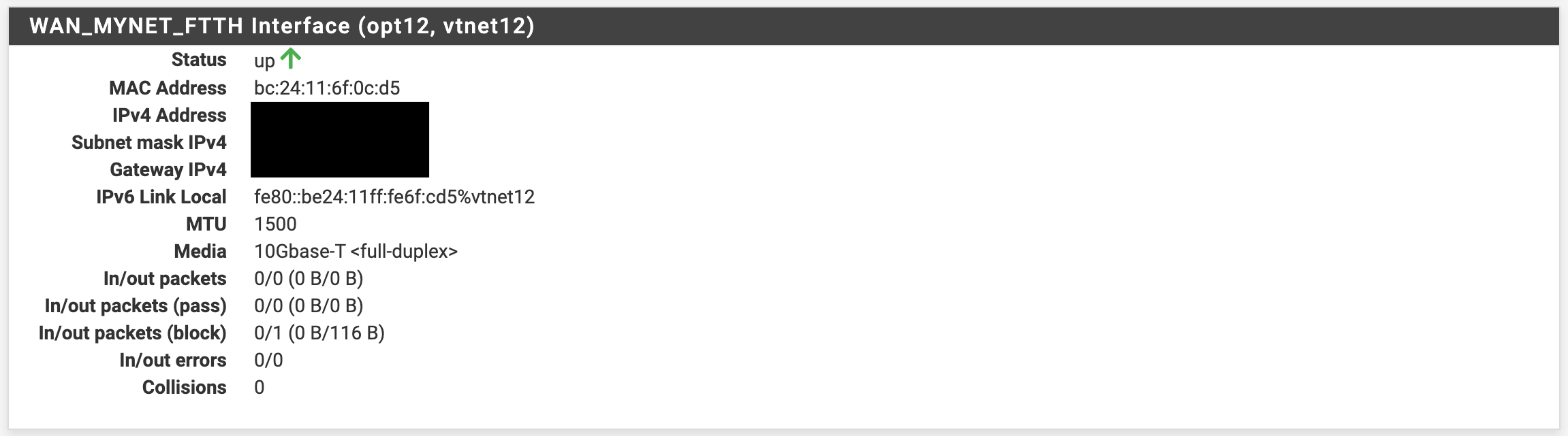

      The interface is marked as up in the interface status:

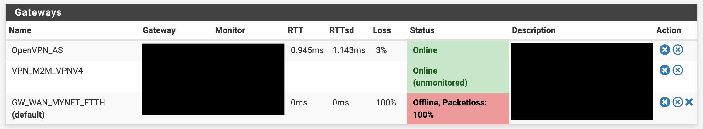

      But no traffic works out of this network connection (ping also returns 100% packet loss to the default gateway IP address):
      After I rolled back to the previous 2.6.0 version everything worked fine like before, with the WAN interface up and working properly again and the CARP interface shown as MASTER.

        Probably a route-to issue. There were several issues there fixed between 2.7.0 and 2.7.2.
        Is that you only WAN interface? Can you see 2.7.2 available?

            You could install 2.7.2 clean and restore a config into it.
            Otherwise I would check the routing table and gateway config.
