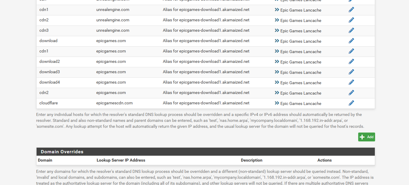

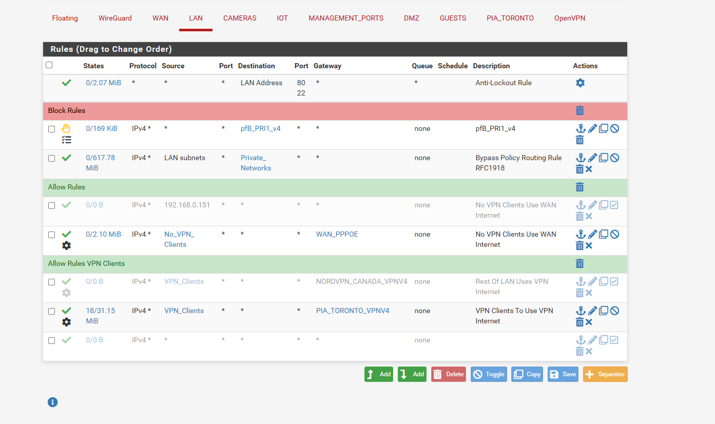

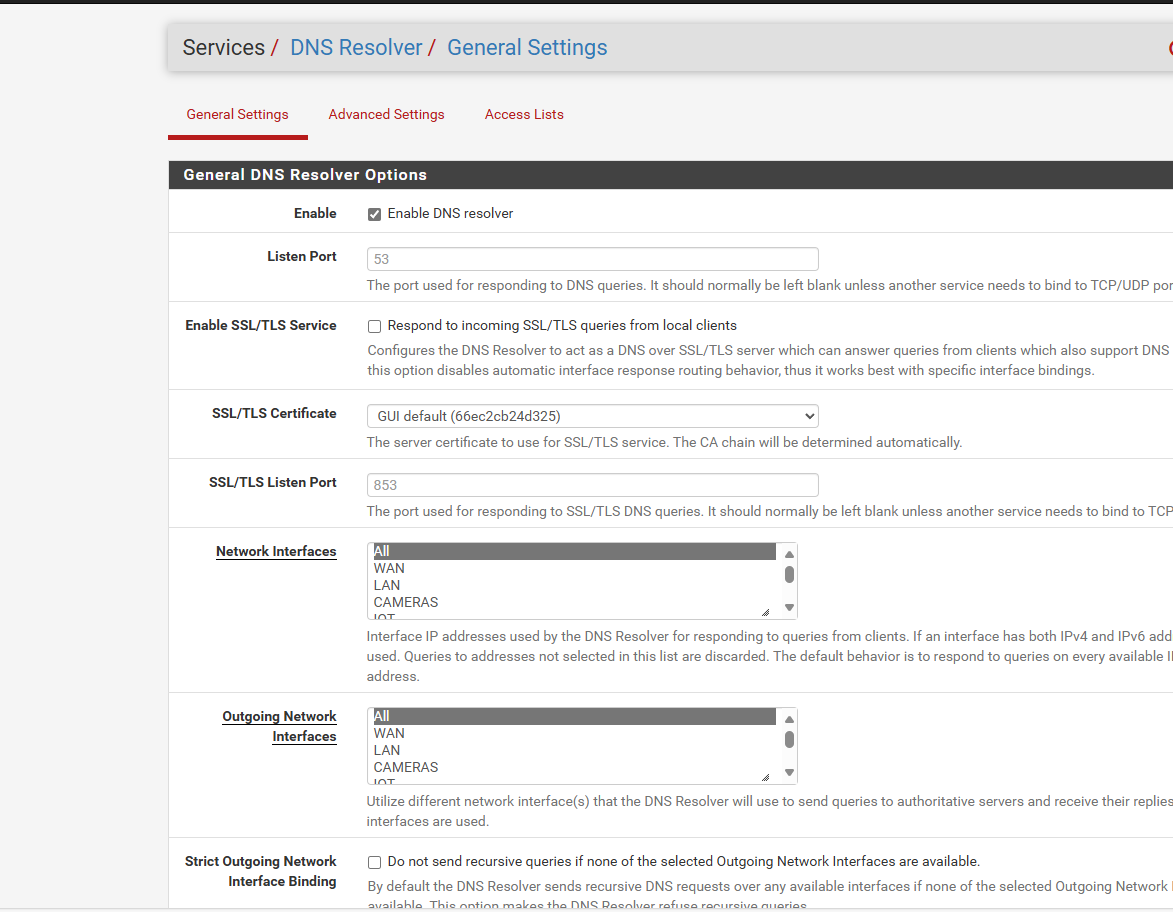

        comet424 @comet424
        here is my lan rules and my dns resolver
          comet424 @comet424
          and here is my nat rules
          if that helps at all

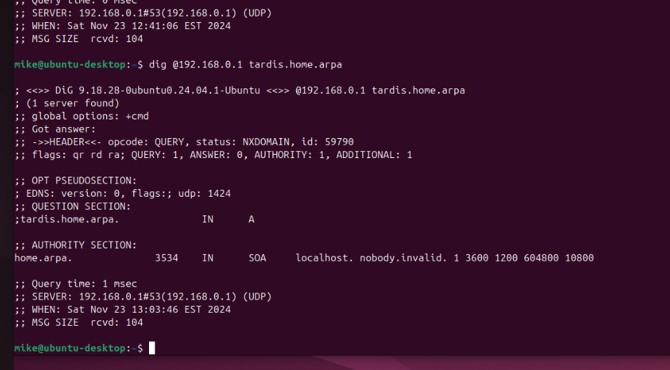

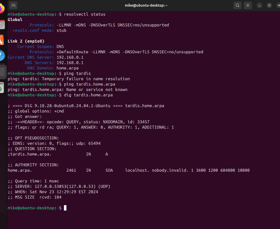

                                and ubuntu and my other unraid boxes can now ping tardis and get the same results
                                no domain name added... do they use other methods then too
                                always learning something new everyday.. and the 24.11 release is that pfsense being released this month i know i had issues when i had 2.7.1 it didnt even know there was an update and when i transitioned to 2.7.2 there was a bunch of glitches in the config file and such that... so i manually re set up everything so entering in all manually so its glitch free.. so hope next upgrade no issues
                                  johnpoz LAYER 8 Global Moderator @comet424
                                  @comet424 have no idea what your doing on your linux boxes.. But if the name was discovered via DNS, then it should come back fq
                                  root@UC:/home/user# ping nas

                                        comet424 @stephenw10
                                        @stephenw10 ah ok so i set the dhcp server domain i put in home.arpa
                                        and i rebooted the ubuntu desktop but still up able to ping tardis
                                        i can ping www.google.ca that has no problem it cant ping locally
                                        so you mean many devices wont allow you to ping tardis or like ping camera10
                                        as example or all my ESP32 devices that run esphome
                                        as for the host override... how do i blank host override to add domain and covers everything on the network.. as so far i only learned you can do like 1 ip address at a time
                                        and i read about split dns and 1:1 nat but all i remember is when i defaulted a clean pfsense i could ping ubuntu and stuff but now where i added vpn and the 1::128 and all those other nats i also wondered if those conflict?
                                        but so far i can ping from
                                        raspberry pi
                                        unraid
                                        windows
                                        pfsense
                                        but i cant seem to ping from any of my ubuntu vms
                                        and i thought if i set dns 192.168.0.1 and in the resolver i set it to all all for incomming and out going that it would resolve things but i guesss not
                                        and even after the reboot and the sudo resolvectl flush-caches i still get same error temporary failture..
                                        i did try this it also failed
                                        if you can show with picture how my host override should look like that would cover everything be good as im a visual learner more over then words to understand things

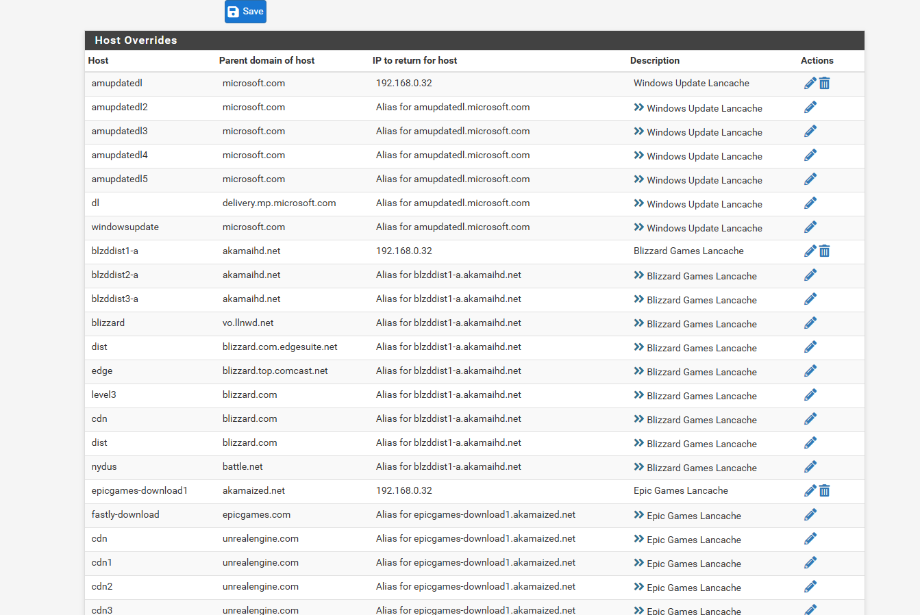

                                          comet424 @comet424
                                          so i tried these 2 different over rides but these didnt work
                                            comet424 @comet424
                                            so with those 2 overrides i have i still can ping from
                                            unraid
                                            windows
                                            but
                                            ubutunu
                                            raspberry pi
                                            gives me issues cant resolve it... is that what you ment many cant resolve tardis just hostname
                                            but what i dont understand is
                                            i tell dhcp that the dns 192.168.0.1 so all clients know pfsense is to dns resolve all the local hostnames... i dont understand why it doesnt do it least not from ubuntu and raspberry pi.. and now i said that the domain that 192.168.0.1 the dns resolver needs to resolve all but it doesnt seem to be working
                                            and here the arpa list the ubuntu desktop doesnt have no .home.arpa.. or the example i gave hell.com so pfsense should be resolving the hostnames no matter what os im pinging from right? least thats how i thought it works
                                            i tried custom options
                                            server:
                                            private-domain: "home.arpa"
                                            that didnt help either
