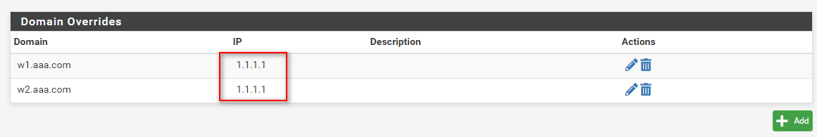

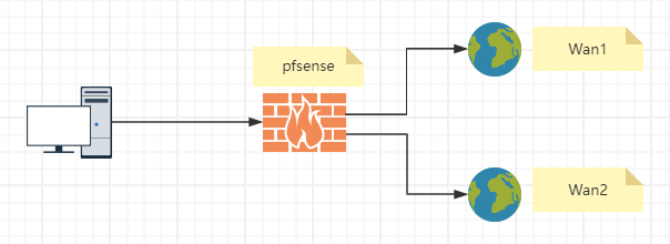

      My simple requirement is to specify two http domain names to query from wan2 port, topology:
      The DNS Forwarder service is enabled, and the configuration and test are successful.
      Question:
      On the DNS Forwarder configuration page, the red marked DNS server (1.1.1.1) must exist in the (General Setup -- DNS Servers) list.
      If I write (2.2.2.2[public network available DNS]) but it is not in the (DNS Servers) list, the test fails.
      Excuse me, is this setting the default rule of pfsense?

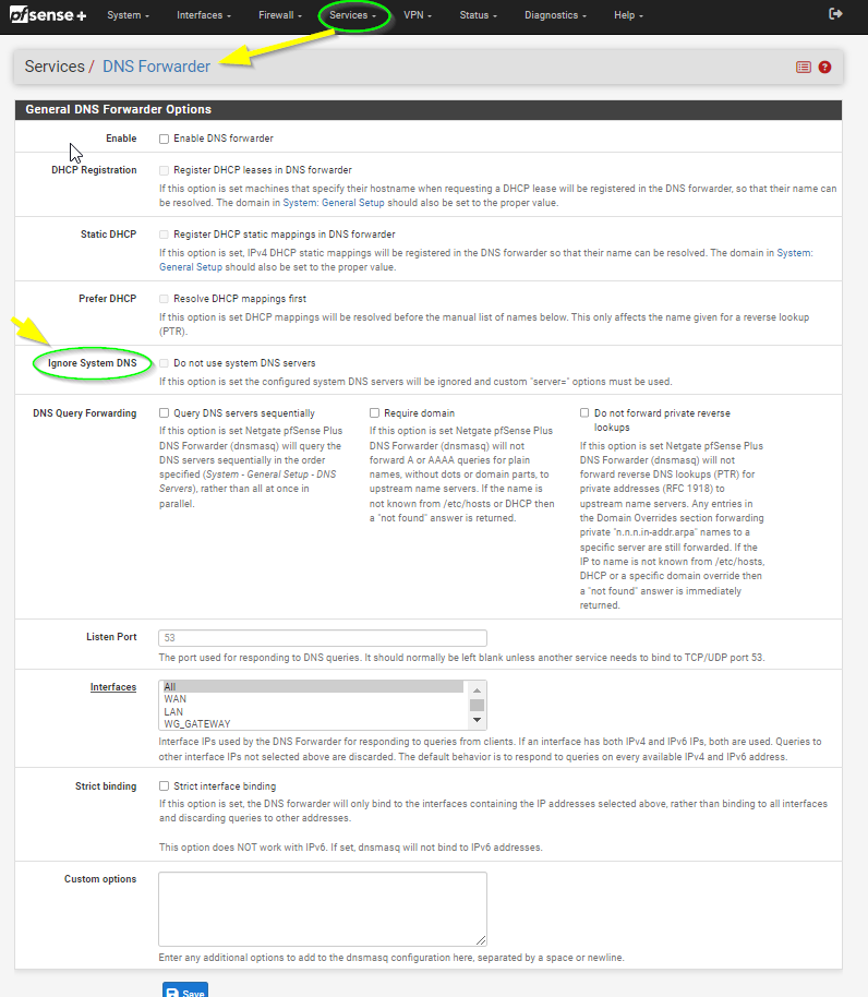

          If you use DNS forwarders only for specific interface (not all), we suggest bypassing general setting with options and specify your specific DNS server. I not find options in documentation but is present in UI.
          If you want to specify an interface to request DNS. Example: w1.aaa.com to 1.1.1.1 via wan2. You need to configure a new route to redirect traffic to specific gateway.

              I want to confirm that the DNS of 1.1.1.1 in the red box must exist in the (General Setup -- DNS Servers) list. It is a hard rule of pfsense,
              right?

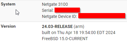

                I use physical appliance Netgate 3100 and version 24.03
                And you can find (Ignore System DNS) in this page:
                right? YES
