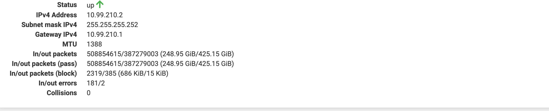

Back to the site-to-site Wireguard VPN.
VPN Tunnel Network 10.99.210.0/30
Peer #1 - VPN - LAN IP address 10.0.1.1 with Tunnel address of 10.99.210.1
Peer #2 - VPN - LAN IP address of 10.1.0.1 with Tunnel address of 10.99.210.2Here is the actual Interfaces for the Wireguard VPN:
Peer #1 -
login-to-viewPeer #2 -
login-to-viewIn terms of the error Log on Peer #2 - I'm getting this:
