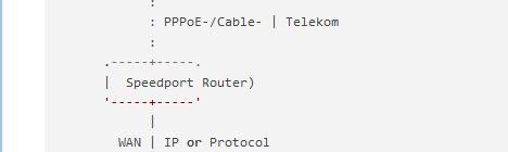

      WAN / Internet
                  : PPPoE-/Cable- | Telekom
            |  Speedport Router)
              WAN | IP or Protocol
            |  pfSense
              LAN | 10.0.0.1/24
            | LAN-Switch |
          ...-----+------... (Clients/Servers)

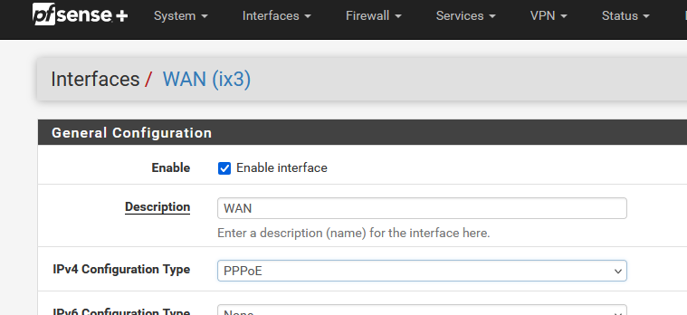

            Using pppoe :
            It could be as simple as : select "PPPoE" :

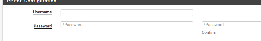

            and fill in this info :
            and done.
