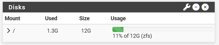

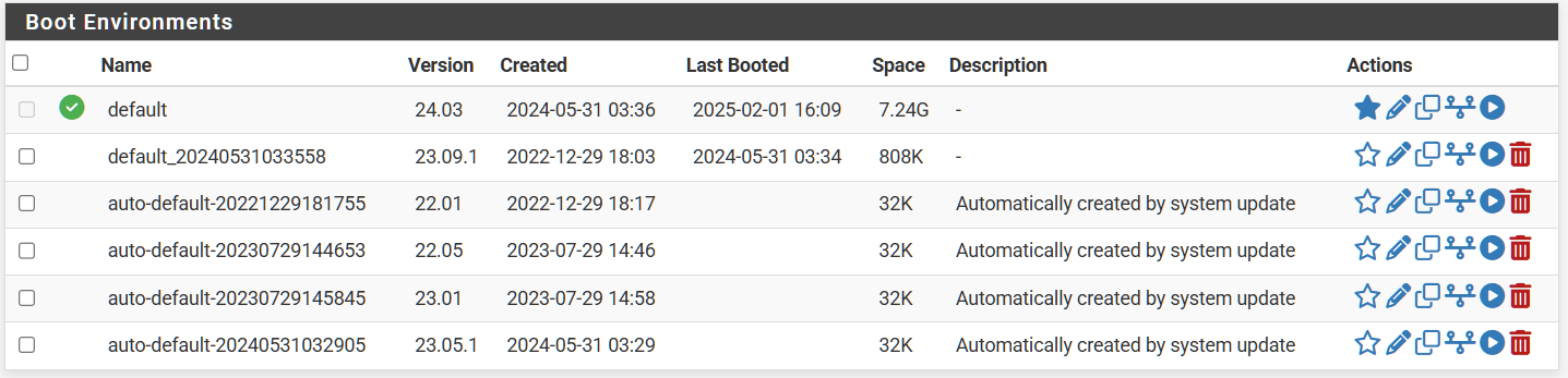

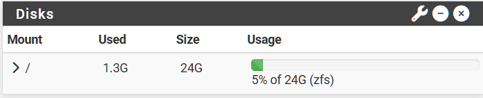

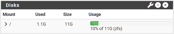

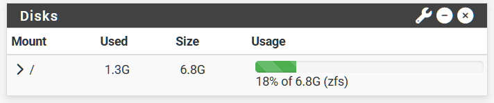

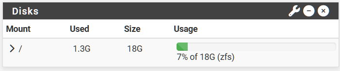

                                andrew_cb @SteveITS
                                @SteveITS said in Another Netgate with storage failure, 6 in total so far:
                                The amount of disk space used by pfSense is typically relatively small so size isn't really a factor unless downloading large lists or data like the UT1 list which is over 1 GB to extract, when it updates. A larger SSD though would have more writing capacity, I'd expect, due to more unused sectors.
                                I think this is a critical part of the equation. Settings and packages that log more than the expected baseline, combined with the behavior of ZFS, lead to more storage writes, which go to a small storage device with TRIM disabled/not supported, and a limited number of spare blocks. This quickly exhausts the approximately 3000 write cycles of the eMMC storage. By my calculations, 5TB is the approximate limit of data that can be written before an 8GB eMMC dies.
