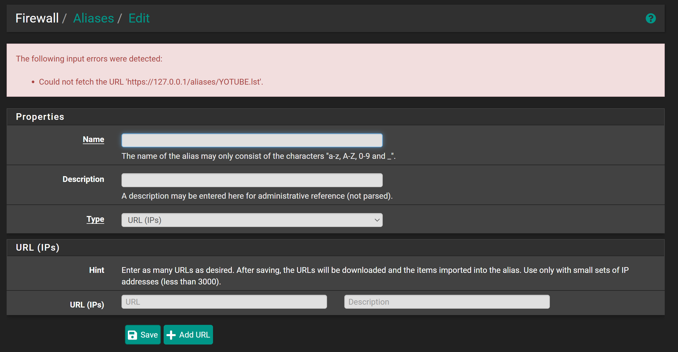

      I need to take care of this because I use it to create a URL alias:
      Is there a solution?

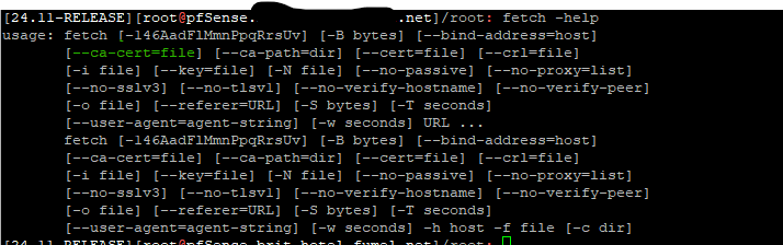

            If you know where the certificate CA is stored, you can probably use a command line option of fetch so it has your CA, and suddenly, no more error ^^
            Yo can give your own CA (a file, dono where it is stored) :
            329a5083-e473-4afc-b2a7-2ce60654141c-image.png fetch -
            So
            fetch --ca-file /some/place/where/your/CA/is https://127.0.0.1/
            would work just fine if 127.0.0.1 is part of the SAN in the cert.

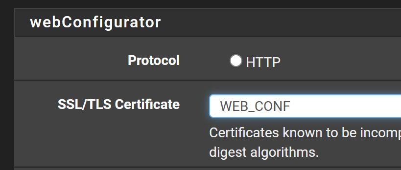

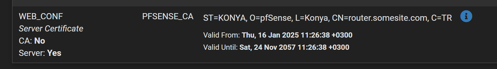

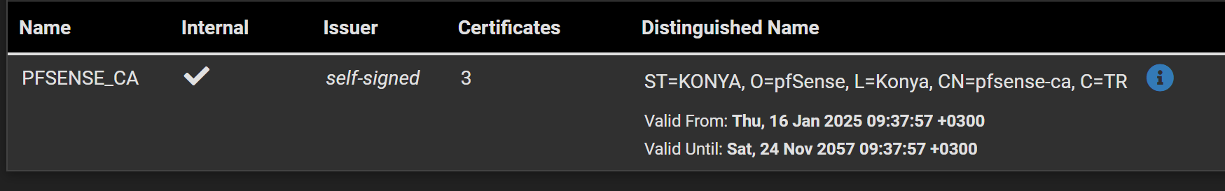

            • S
              scilek @Gertjan
              @Gertjan

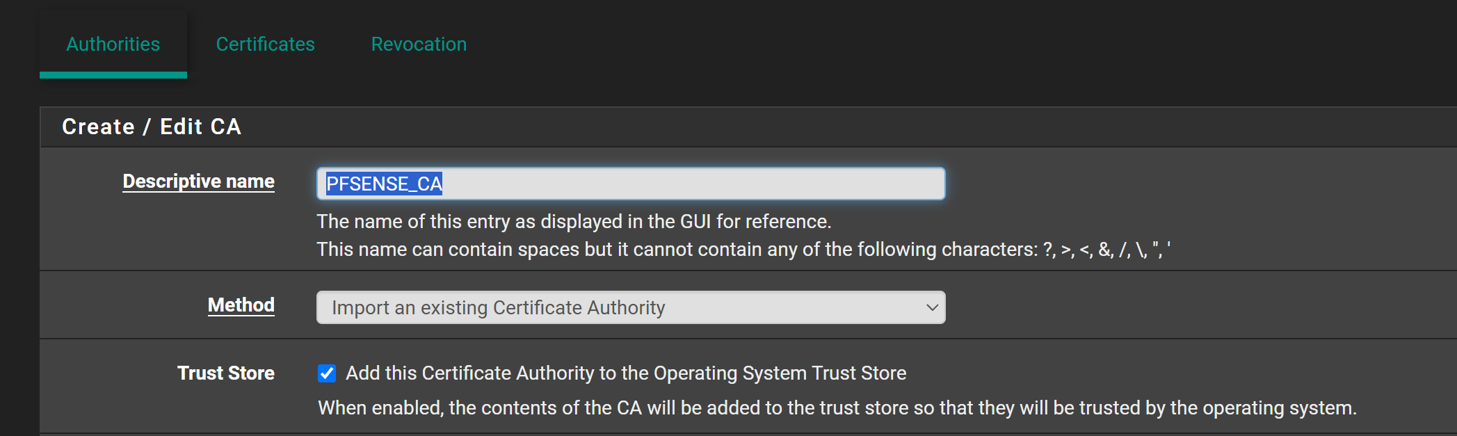

              I don't think pfSense stores the certificates anywhere, they are all in the config.xml file.
              Also the custom CA I have created (is PFSENCE_CA) is trusted:

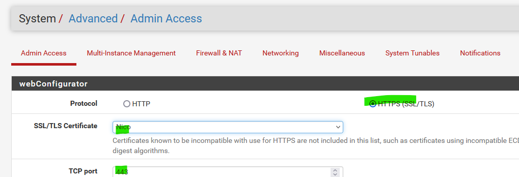

                The web server ("GUI"), if it has https enabled :
                it needs to have a cert, mine is called 'Nico'.
                Let's have a look :

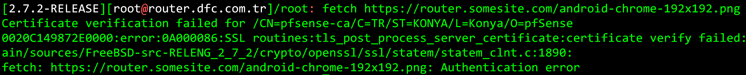

                  scilek @Gertjan
                  @Gertjan
                  Well, thanks. That did work:
                  [2.7.2-RELEASE][root@router.somesite.com]/root: fetch --ca-cert=/var/etc/cert.crt https://router.somesite.com/android-chrome-192x192.png
