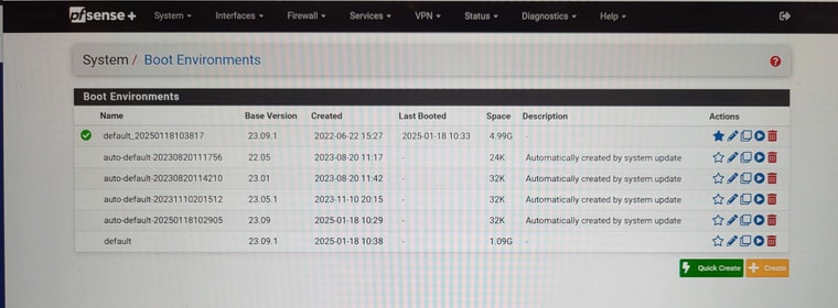

          Here's what my Boot Environments look like (sorry for the quality, my computer connected to the Netgate UI is offline):
          Are any of these environments safe to delete?
          patient0P A 2 Replies Last reply Reply Quote 0
          • patient0P Offline
            patient0 @alban4
            @alban4 you can delete the auto-default-20230820111756 (22.05), auto-default-20230820114210 (23.01), auto-default-20231110201512 (23.05.1) ones for sure. These are old pfSense versions.
            After that you can have another go at the update. The space column is not accurate for ZFS due to the nature of how ZFS works, it can free a lot more space then shown in the space column.

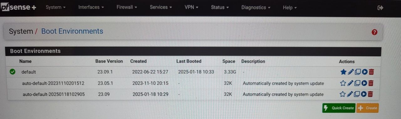

              So I went ahead and deleted 2 of the oldest boot environments: 22.05 and 23.01. I figured it wouldn't make much of a difference since they were using so little space.
              But as a result, the bottom boot environment "default 23.09.1" became the default boot environment, and default_20250118103817 disappeared. Here's the new state of things:

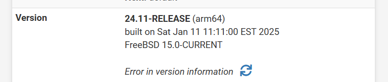

                    @patient0 Thanks a lot for your help. Thinks are looking much brighter now. I was able to retry the update to version 24.11, and it completed successfully this time.
                    After a reboot, the dashboard shows the new version:

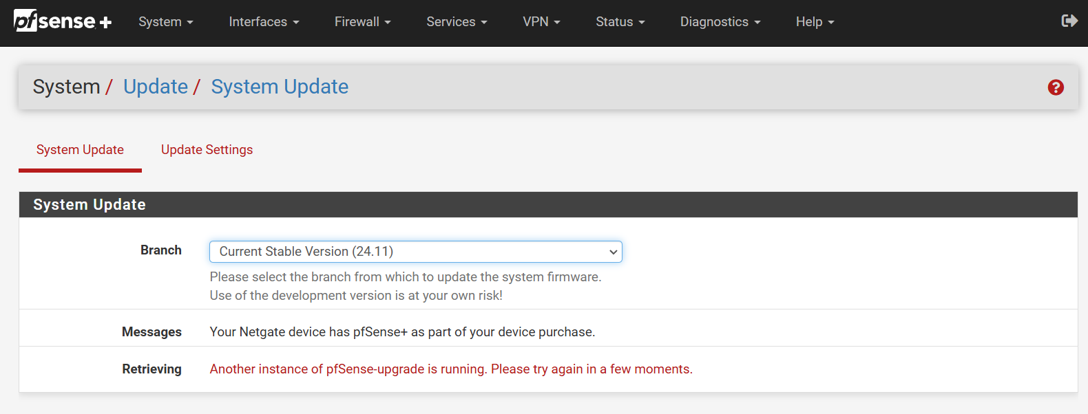

                    However, if I navigate to System Update, it appears to think the upgrade that was hanging earlier is still running:
                    Is it possible to kill that failed upgrade for good? Otherwise, I might be stuck at version 24.11 forever.
                    • patient0P Offline
                      patient0 @alban4
                      @alban4 said in Upgrade to version 24.11 hangs because disk full:
                      No I don't think so, that's just the upgrade check after a reboot which conflicts with your upgrade check. Give it a some time (don't know, 3 Minutes) and it will be ok.
                        alban4 @patient0
                        @patient0 You're right! It did end up showing "Status Up to date." eventually. Looks like I'm back in business now.
