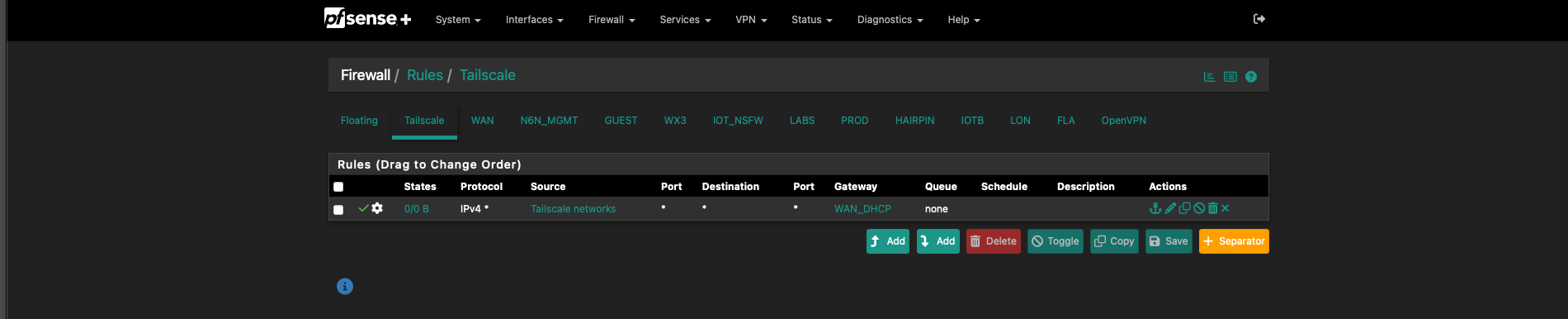

@stephenw10 This is what I have in the Firewall tab.
That's the firewall rules for it but did you assign the interface?

But either way setting the source to the subnet rather than the system alias will allow the ruleset to load.
