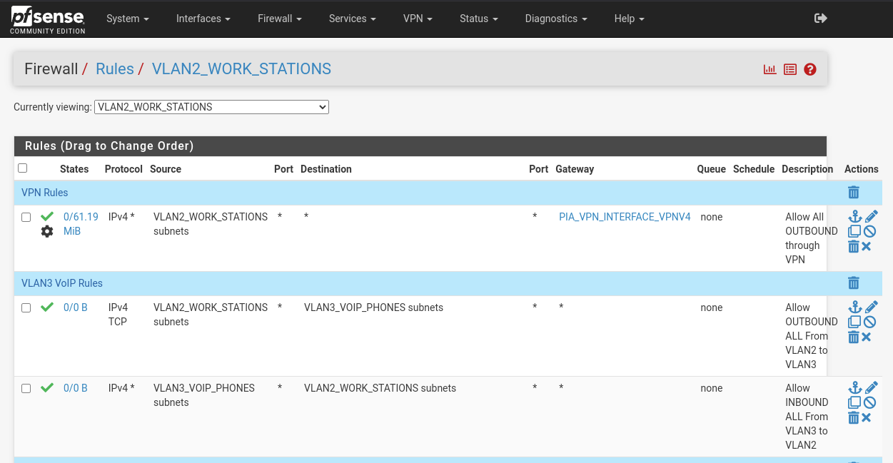

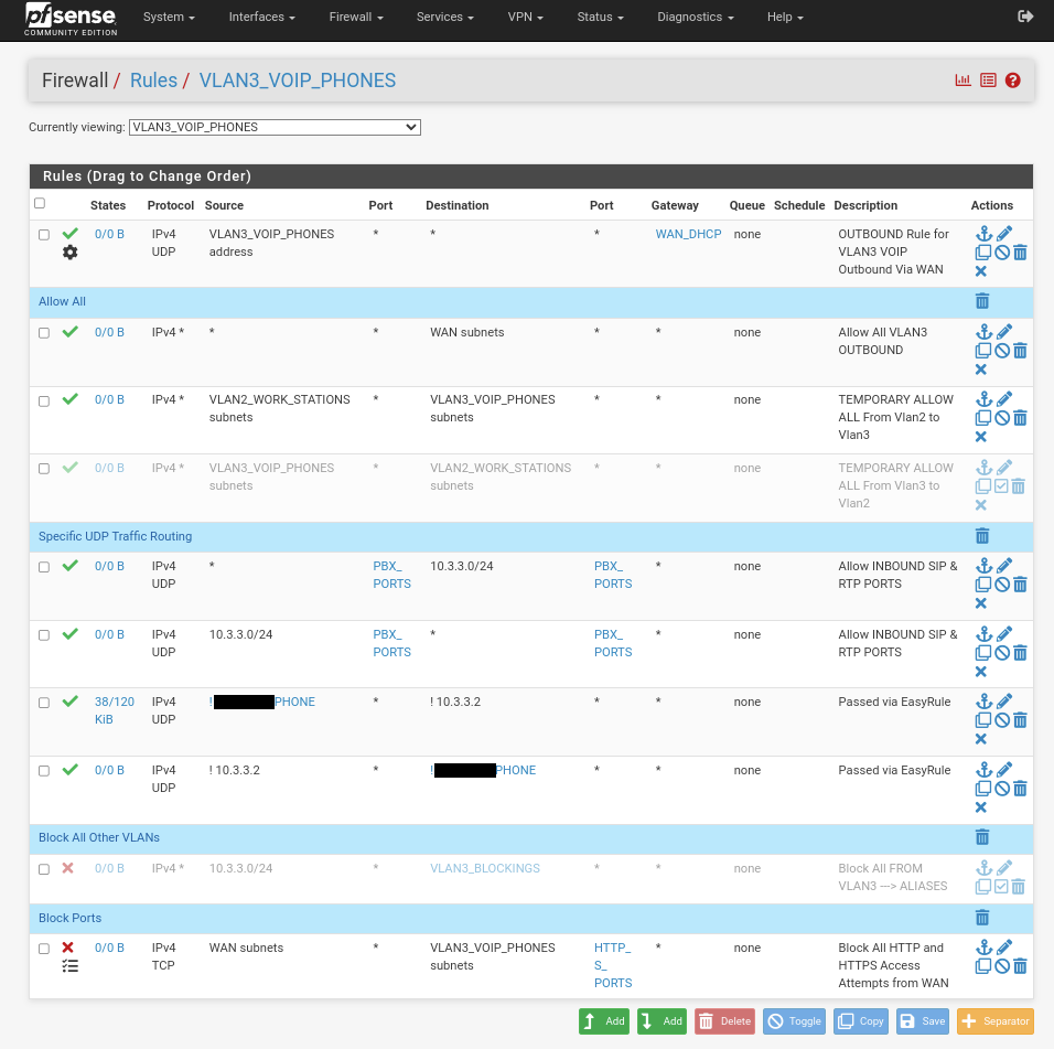

        VLANs: There are 20+ VLANs (e.g., VLAN2: 172.x.x.0/24, VLAN3: 10.x.x.0/24, etc.) configured with specific IP ranges. Each VLAN is served by pfSense's DHCP server.
        VPN: Configured to activate only when the WAN gateway (WANGW) is online.
        There is a kill switch that blocks traffic for VPN-connected VLANs if the VPN fails.
      Firewall Rules:
      All VLANs previously worked perfectly with inter-VLAN communication allowed via rules.
      Each VLAN has explicit "allow all" bidirectional rules for testing inter-VLAN traffic during troubleshooting.

      Example: Devices in VLAN2 (172.x.x.0/24) cannot ping devices in VLAN3 (10.x.x.0/24), even with "allow all" rules for both VLANs.
      I have also added configs in the NAT Outbound section to 'No NAT' between VLANs, this has no effect at all, the same problem exists, no inter-VLAN comms.
      Using Packet Capture, I see ICMP packets leaving VLAN2 client but not reaching VLAN3 client. The destination VLAN shows no trace of the packets. I can see other packets that are reaching the client target from the WAN interface itself, but I cannot see any packets originating from VLAN2 (for example)

                    Ok the fact you have no auto rules added means pfSense doesn't see it as a WAN, no gateway on it, but it should have because you see it in the dhcp status.
                    You should not need to add a gateway at all and doing so is probably causing a problem.
                    You probably lose connectivity between the VLANs when the gateway comes up because the firewall rules on those VLANs have policy routes, gateways defined? Presumably the WAN_GW?
                    If so need bypass rules without a gateway defined to allow direct routing.
                    @fxpro said in Inter-VLAN Communication and WAN Connectivity Issues After Switching from PPPoE to DHCP/Static:
                    WAN >>> VLAN2 Source >> Source Port * >> VLAN3 Destination >> Destination Port * >> NAT Address (NO NAT) >> NAT Port *
                    WAN >>> VLAN3 Source >> Source Port * >> VLAN2 Destination >> Destination Port * >> NAT Address (NO NAT) >> NAT Port *

                          • stephenw10S Online
                            There is no rule there allowing a host on VLAN3 to ping a host on VLAN2. Or rather the only rule that would allow it is disabled.
                            How exactly are you testing? What IP are you trying to ping from?
                            • F Offline
                              fxpro @stephenw10
                              @stephenw10 how is there no rule to ping to VLAN3?
                              look here:
                              How is this not a rule?
                              And if it was incorrect, how come it works when I remove the WAN_DHCP? Doesn't make sense.
                              In relation to your question about the rules and where I'm pinging from...
                              I'm pinging from (VLAN2) 172.16.2.150 to (VLAN3) 10.3.3.2
                              Thats exactly what the rule above does.
                              I can even make it specific using the actual IP Addresses, it makes no difference, the same result occurs.
                              Additionally, I have made a rule also where ALLOW ALL/ANY and I still get the same result, I cannot ping whilst WAN_DHCP is enabled. The moment I disable the WAN_DHCP and reboot the pfSense, when its booted up again, I can ping between the VLANs as correctly specified in the image.
                              The rule you see disabled is on purpose, but even with it on doesn't change anything. That rule is for VLAN3 to ping VLAN2 which is not what I'm doing as mentioned above. Either way, with it enabled, changes nothing because I ping from VLAN2 172.16.2.150 to VLAN3 10.3.3.2.
                              I don't know what else to do, I'm completely at a stand still. Please help.
                              Any idea why its doing this?
                              do you want to see more config?
                              I can also show you logs if you need?
                                If you are pinging from VLAN2 to VLAN3 then the rules governing that are on VLAN2. Your screenshot above shows the rules on VLAN3 so none of those apply.
                                What rules do you have on VLAN2?
                                • F Offline
                                  fxpro @stephenw10
                                  @stephenw10 here are the VLAN2 rules:
                                  As you can see, VLAN2 allows traffic to VLAN3
                                  Thus:
                                  VLAN2 ---> VLAN3 is here:
                                  and on VLAN3, allows traffic from VLAN2 to VLAN3 here:
                                  Again, this has nothing to do with the problem.
                                  As I've shown previously, this was working when I was on the PPPoE connection.
                                  In fact, I can also get this working if I Disable WAN_DHCP !!!
                                  But the moment I Enable WAN_DHCP, I lose inter-VLAN connectivity !
                                  This has absolutely NOTHING to do with firewall rules and from what I can see, everything to do with Routing to 'a' gateway. The problem is WHY do the packets route to the WAN gateway for internal inter-VLAN traffic when it should be routing to the local network gateway/s, when I have enabled WAN_DHCP ?
                                  When WAN_DHCP is disabled, I will get the correct routing to the local gateway for inter-VLAN traffic. Why is this occurring? Maybe there is a section in the GUI where I can force this?
                                  If I can find the reason why this is happening, I can solve the problem, because to me it is clear this is a Routing to gateway problem and I can prove it repeatedly, if I disable WAN_DHCP because I will regain inter-VLAN connectivity.
                                  • Surely this is a bug?
                                  • Is there a work around?
                                  • Can I make a bug report to Netgate? if so where?
                                  Please help, getting desperate now.
                                    Ok so that top rule will catch all traffic from anything is VLAN2 and force it via the VPN gateway. The only time that doesn't happen is if the VPN is down.
                                    You need a rule above that to pass traffic from VLAN2 to VLAN3. And if you want that to allow pings it must be either 'any' protocol or ICMP.
                                    Firewall rules (on any tab except floating) are applied to traffic coming into that interface.
                                    So the rule you have with source VLAN3 subnets there can never match any traffic. All traffic on the VLAN2 tab will have source VLAN2 subnets. The same is true for some rules you have on the VLAN3 tab.
                                    So it looks like this explains what you are seeing with regards to the gateway. When the system has a default gateway the VPN connects that then the top rule forces all traffic via that preventing pings between VLAN2 and VLAN3. Without a default gateway set the VPN cannot connect so the VPN gateway is invalid. The default behaviour is for the rule to be applied without a gateway set so that then allows pings. That can be changed.
                                    But adding a rule to by-poass policy routing for local traffic on VLAN2 will correct this.

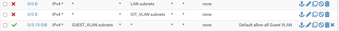

                                      • G Offline
                                        Gblenn @fxpro
                                        @fxpro It certainly helps to know, as @stephenw10 said, that rules work from the top to bottom. But the key here is the moment a rule catches some form of traffic, no further rules below will apply to that traffic.
                                        Also, check the numbers in the states column, where 0/0 indicates the rule has not been used at all.
                                        Also good to know, when you created your VLAN, you already have one invisible rule in place, the default deny all. So nothing goes out anywhere until you allow it to.
                                        Typically the first rule to add, is that "default" allow VLAN-X to any rule. This will give VLAN IP's internet access, as well as access to any other subnets in your setup.
                                        However, one key reason for VLANs is to isolate different types of traffic or users from each other. So most commonly you would add deny rules to block inter VLAN access, above that all to any rule. Something like what I have for my GuestVLAN used on wifi, allowing internet access but nothing else.
                                        If you then want to add some policy that allows some IPs to access another subnet, you start adding those rules above the block rules. Perhaps you have a PiHole on LAN that you want to use also for VLAN2 and VLAN3, so then you create allow rules from VLAN2 and VLAN3 respectively with Destination PiHoleIP, and so on.
