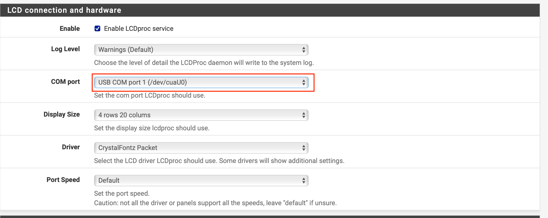

        @ngr2001
        I use the following port.
        USB COM port 1 (/dev/cuaUO)

            @ngr2001
            it's the same physical port just a different kernel driver. From what I read tty is for dial-in devices and cua is for dial-out devices.
