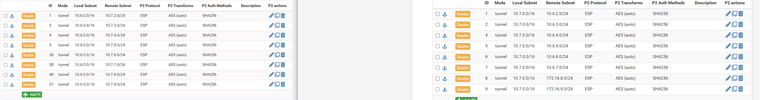

                    @stephenw10 P2.PNG here's the P2 config vlan 2-5 can access both ends but vlan6-9 can't access any vlan.
                      Hmm, well those P2s don't match so if one side tries to open a P2 with a /16 defined the other side will reject it.
                      You should see a bunch of errors in the logs for that though. And I wouldn't expect to see the P2s come up in the status.
