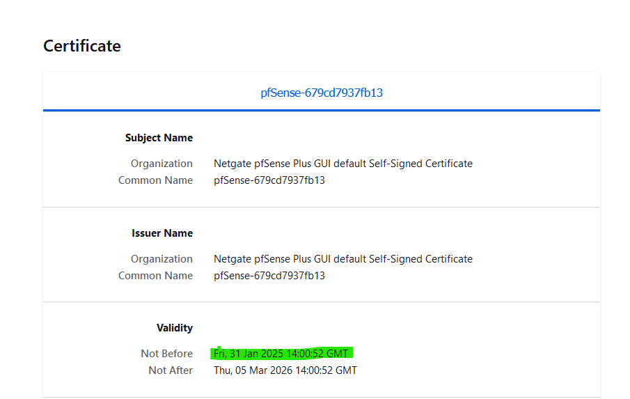

This created a new GUI self-signed certicate, and the GUI was set to use it :
But my browser (FF) refused to use it ....
( I know, I can reset the GUI by set it to use http a and not https, now I can access the GUI,, export the new cert for the GUI, import in into my system so the browser won't complain anymore, and now switch back to https ... pfffff ) -
