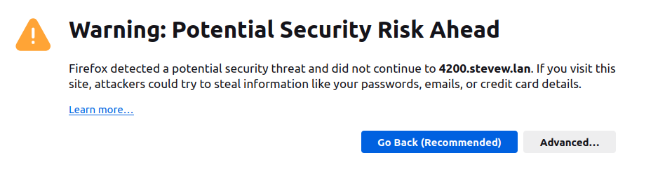

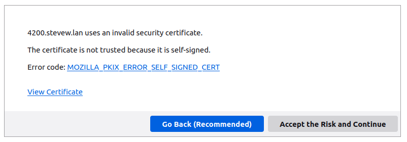

                          Does it tell you what the issue is?
                          The usual warning from the self signed cert is:
                          But you can just accept that and it won't usually ask again.
                          • H Offline
                            hspindel @stephenw10
                            @stephenw10 Yes, that is the exact same warning screen I see. Unfortunately it reappears no matter how many times I accept it.
                              Hmm, that has to be a security setting in Firefox.
