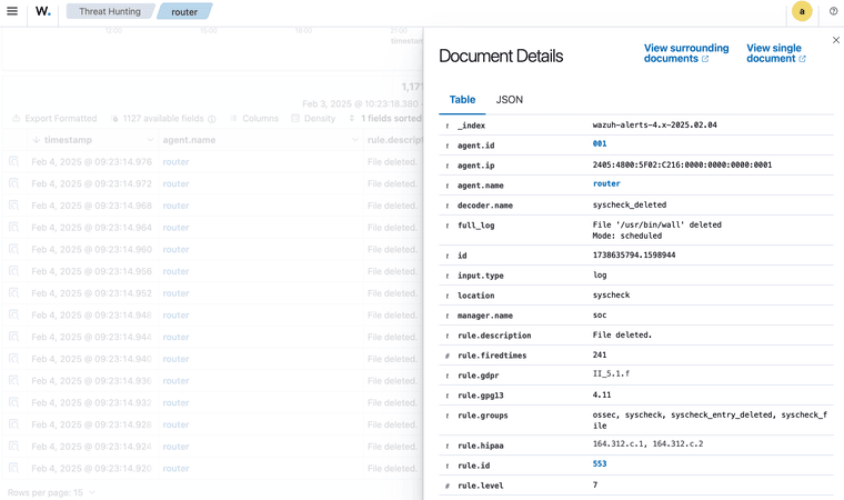

      I'm reaching out seeking assistance regarding a concerning issue with my firewall setup using pfSense Plus with the latest firmware - as a virtual machine within ESXi - which I've setup Wazuh-Agent on for endpoint protection and threat detection, connected directly to a dedicated Wazuh Server. . Here's the breakdown of the problem:
      The Issue: Recently, Threat Hunting in the Wazuh Dashboard has indicated a significant number of files have been deleted from the /usr/bin folder on my pfSense Plus. These include key tools such as what, vmstat, vtfontcvt, wall, etc... Despite the firewall continuing to operate normally, this deletion is raising red flags. Also I haven't upgraded or performed any major changes recently.
      Requesting Help: I'm keen on understanding the potential causes of these deleted files and investigating whether any malicious activity is at play:
      Suggestions for Investigation: What steps should I take next?
      Identifying Potential Causes: Do you have expertise in identifying how such deletion events might be possible?
      Any insights or suggestions would be greatly appreciated.
      Thanks a lot.

        File '/usr/bin/wall' deleted
        Mode : scheduled
        Deletion was scheduled ?

        So, yeah, system files that get deleted by the kernel (the only one who can do so **), as it was ordered to do so by a user-land application, like 'rm' and a connected user or any other process wants to remove OS core user land process files (programs) ... great. Something tells me its not pFsense doing this ^^
        Tell us what happened, and we'll tell you what happened ^^
        ** I guess the good old disk sector edit tool would still work just fine also.
          Were those binaries replaced? What's the file timestamp compared to others? What pfSense version are you running?
          Do you have the full list of deleted binaries?
