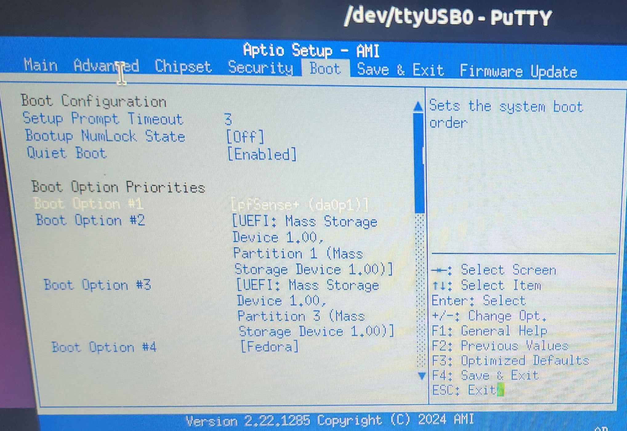

                                I see the first boot is da0p1 which should be the eMMC. I moved my USB up to 2 and 3.
                                On powerup, it skipped right over the eMMC and booted directly into my USB memstick. I tried to run the installer, but it said it could not locate a storage device.
                                Any other ideas before installing an NVMe drive?

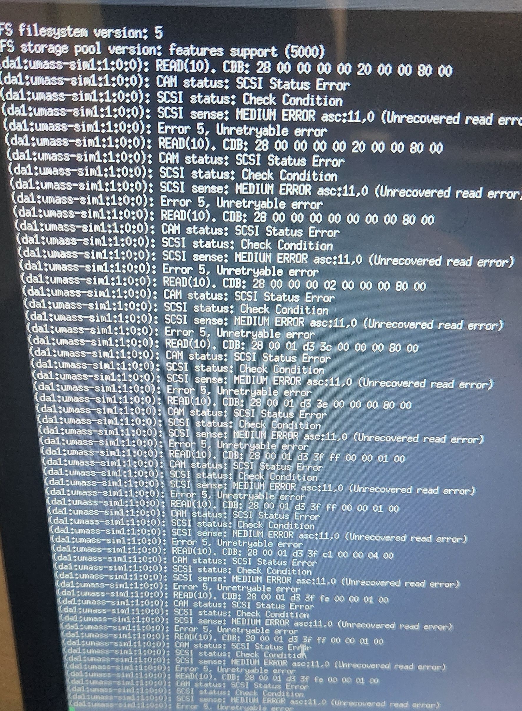

                                    For what it is worth, a little bit more information for thread. I disconnected the cables and noticed how hot the system was. I let it cool down for a while and plugged it back in to see if anything changed after a bit of a cool down. It tried to boot up to the eMMC but it generated many errors. I tried to reinstall the software and the same errors. 20250510_183115.jpg
                                    Not sure if this is something a recovery tool of some sort can fix.
                                    I've got an NVME now and will let you know when I'm back online.

                                      Back online with an NVMe. However, the whole wiping of existing disks (and references to it) was a total failure. No matter which commands I tried to wipe the disk, none worked because it couldn't read/write to the eMMC (da1) drive to "delete" it. The best I could do was not allowing it to be part of the boot process.
                                      Even after installing the new NVMe, I'm still getting errors from da1 on boot up. I don't know if during the boot it does some kind of sanity check on all the drives first but once it is done, it boots on to the new NVMe.
                                      So, for now, I'm back online. I'm going to spend some time tomorrow exploring why I'm still getting drive issues.
                                      Netgate got me on this one. 14 months in and I had to dish out some extra $$ because I'm just outside their warranty window. I've had good luck in the past with an sg-1100, 3100, and 5100. The 4200 was the POS. Here's hoping I get a few more years out of it.

                                        The external config loader tries to read da devices at boot to check for config files in root. That's probably what you're seeing there.
                                        So it just throws errors when you try to gpart destroy or zpool labelclear it?
                                        P 1 Reply Last reply 8 days ago Reply Quote 0
