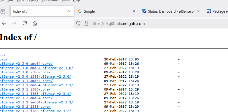

            @hiflyr777 said in Package repo connection issues on fresh bare metal install:
            Direct HTTPS connections to pkg00-atx.netgate.com:443 and pkg01-atx.netgate.com:443 time out
            For what it's worth : when I copy these two in my browser :
            As you've installed very recently, what about : console option 4 : reset to default.
            When it reboots, on the console, assign the minimum default settings for WAN and LAN.
            You are allowed to chose a password. You are not allowed to change or modify or even look at DNS settings.
            When done, you should have working setup, as the default Netgate Initial setup always works. If the issue is still there, the problem isn't pfSense.
