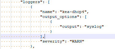

      2. kea-dhcp4.conf
        file location: /usr/local/etc/kea/kea-dhcp4.conf
        Change in section "loggers" the entry for "severity". In my case, the level was set to "WARN". Based on the Kea documentation there are 5 different log levels: DEBUG, INFO, WARN, ERROR, FATAL (https://kea.readthedocs.io/en/kea-2.2.0/arm/logging.html).
        My final entry was: "severity": "INFO"

        Gertjan @LaUs3r
        @LaUs3r said in How to change Kea DHCP log level:
        keactrl.conf:
        Afaik, the process (program) keactrl isn't used by pfSense.
        The GUI starts "/usr/local/sbin/kea-dhcp4" (with config file /usr/local/etc/kea/kea-dhcp4.conf)
        and
        /usr/local/sbin/kea-dhcp6 with config file /usr/local/etc/kea/kea-dhcp6.conf
        • if you have IPv6 LAN(s) directly.
        Your 2) is .... well ... will work only ones.
        You've said it yourself :
        The change to the kea-dhcp.conf is not persistent, i.e. does not survive a reboot
        Consider this over simplified description of pfSense - the GUI.
        It's a nice looking super config file creator.
        So the very next time a process, like the DHCPv4 server kea-dhcp4, gets restarted, first, the config file is re created using GUI stored settings, and then the process is started.
        At that moment, your own edits of a file like /usr/local/etc/kea/kea-dhcp4.conf are gone.
        So, it won't survive a reboot, and it won't survive the very next process restart, for example when you save the DHCPv4 server settings page, for example.
        If you want to change the log "severity", have a look at /etc/inc/services.inc
        I presume you use 24.11 - pfSense Plus.
        Look here.
        Change you /etc/inc/services.inc, locate the same line, change WARN for INFO, save, restart DHCPv4 (kea) and voila.

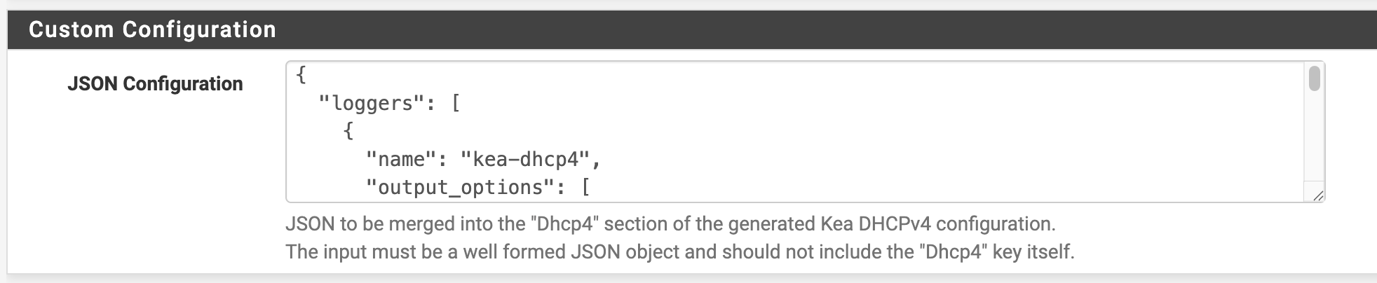

            This should work according to the docs (but it doesn't seem to!) ... add to Custom Configuration section at the bottom of Kea options:
              "name": "kea-dhcp4",
              "output-options": [
                  "output": "/var/log/kea-dhcp.log",
                  "maxver": 8,
                  "maxsize": 204800,
                  "flush": true,
                  "pattern": "%d{%j %H:%M:%S.%q} %c %m\n"
              "severity": "INFO",
              "debuglevel": 0
            Not sure why it's not working. The file does get created but its size remains 0 bytes—nothing is logged. pfSense 25.07.

                @luckman212
                I've been playing with JSON stuff for kea in the past, so I gave it a try.
                On the Services > DHCP Server > Settings page, I added :
                  "option-def": [
                      "name": "unifi",
                      "code": 1,
                      "space": "vendor-encapsulated-options-space",
                      "type": "string"
                  "loggers": [
                      "name": "kea-dhcp4.alloc-engine",
                      "output-options": [
                          "maxver": 8,
                          "maxsize": 204800,
                          "flush": true,
                      "severity": "DEBUG",
                      "debuglevel": 99
                The first part, called "option-def", handles a DHCP option for my "unifi" equipment.

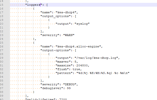

                Before you start to modify anything, first, have a look at the actual /usr/local/etc/kea/kea-dhcp4.conf file.
                There is already a "option-def" section, set up by pfSense itself.
                My idea was to add a sub section for ""kea-dhcp4.alloc-engine" as I thought that would add lease info in the r/log/kea-dhcp.log file. EDIT : bad idea, keep on reading, the perfect solution will be found shortly hereafter.
                When you save, there shouldn't be any warning, double check the Status > System Logs > System > General page.
                There should be no errors messages - also shown in the GUI in the top right.
                Now, just to be sure, re check the /usr/local/etc/kea/kea-dhcp4.conf file. You should see what you've added.
                For example, I see :
                and the file "/var/log/kea-dhcp.log" now exists, and is populated :
                233 06:27:54.843 kea-dhcp4.alloc-engine ALLOC_ENGINE_V4_NO_MORE_EXPIRED_LEASES all expired leases have been reclaimed
                233 06:28:03.861 kea-dhcp4.alloc-engine ALLOC_ENGINE_V4_RECLAIMED_LEASES_DELETE begin deletion of reclaimed leases expired more than 3600 seconds ago
                233 06:28:03.861 kea-dhcp4.alloc-engine ALLOC_ENGINE_V4_RECLAIMED_LEASES_DELETE_COMPLETE successfully deleted 0 expired-reclaimed leases
                233 06:28:04.863 kea-dhcp4.alloc-engine ALLOC_ENGINE_V4_LEASES_RECLAMATION_START starting reclamation of expired leases (limit = 100 leases or 250 milliseconds)
                233 06:28:04.863 kea-dhcp4.alloc-engine ALLOC_ENGINE_V4_LEASES_RECLAMATION_COMPLETE reclaimed 0 leases in 0.007 ms
                233 06:28:04.863 kea-dhcp4.alloc-engine ALLOC_ENGINE_V4_NO_MORE_EXPIRED_LEASES all expired leases have been reclaimed
                233 06:28:05.337 kea-dhcp4.alloc-engine ALLOC_ENGINE_V4_REQUEST_EXTEND_LEASE [hwtype=1 ee:fa:f2:08:1c:58], cid=[01:ee:fa:f2:08:1c:58], tid=0xae5c96bf: extending lifetime of the lease for address 192.168.2.25
                233 06:28:15.708 kea-dhcp4.alloc-engine ALLOC_ENGINE_V4_LEASES_RECLAMATION_START starting reclamation of expired leases (limit = 100 leases or 250 milliseconds)
                233 06:28:15.708 kea-dhcp4.alloc-engine ALLOC_ENGINE_V4_LEASES_RECLAMATION_COMPLETE reclaimed 0 leases in 0.007 ms
                233 06:28:15.708 kea-dhcp4.alloc-engine ALLOC_ENGINE_V4_NO_MORE_EXPIRED_LEASES all expired leases have been reclaimed
                233 06:28:25.773 kea-dhcp4.alloc-engine ALLOC_ENGINE_V4_LEASES_RECLAMATION_START starting reclamation of expired leases (limit = 100 leases or 250 milliseconds)
                233 06:28:25.773 kea-dhcp4.alloc-engine ALLOC_ENGINE_V4_LEASES_RECLAMATION_COMPLETE reclaimed 0 leases in 0.011 ms
                233 06:28:25.773 kea-dhcp4.alloc-engine ALLOC_ENGINE_V4_NO_MORE_EXPIRED_LEASES all expired leases have been reclaimed
                233 06:28:29.792 kea-dhcp4.alloc-engine ALLOC_ENGINE_V4_RECLAIMED_LEASES_DELETE begin deletion of reclaimed leases expired more than 3600 seconds ago
                233 06:28:29.793 kea-dhcp4.alloc-engine ALLOC_ENGINE_V4_RECLAIMED_LEASES_DELETE_COMPLETE successfully deleted 0 expired-reclaimed leases

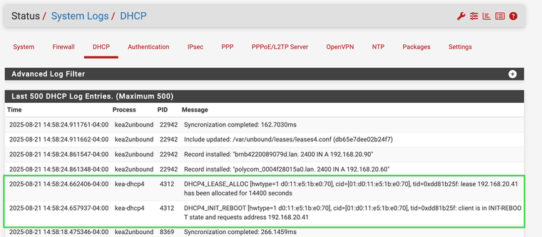

                            luckman212 LAYER 8 @keyser
                            @keyser Here you go...
                              "loggers": [
                                  "name": "kea-dhcp4.leases",
                                  "output-options": [
                                      "output": "syslog:kea-dhcp4",
                                      "pattern": "%m\n"
                                  "severity": "INFO",
                                  "debuglevel": 0
                            Logs will be handled by syslog, and written to /var/log/dhcpd.log:

                              @luckman212 Whooaaa, I thought @Gertjan stated that you could not use a pfSense managed log file, but it of course makes sense that it can log to that file as that is the default log file of KEA in pfSense. So if nothing is stated and size managed like in your JSON, then it's in the default location.
                              EXCELLENT work gents! Thank you very much for the investigative work :-)
                              PS. Perhaps Netgate (@stephenw10) should consider adding that logging part to the default KEA config in the builtin setup - to mimic the logging setup of ISC?
                              GertjanG 1 Reply Last reply Reply Quote 2
                                Gertjan @keyser
                                @keyser said in How to change Kea DHCP log level:
                                This - you see the file name ? :
                                don't pick a (log) file name that pfSense (syslog actually) already uses.
                                On the other hand : this :
                                is not a file ^^
                                will send the log lines not to a file, but to the syslog socket, and from then on syslog will sift it out. Syslog discovers that it is a DHCP log line, and outputs it to the syslog/pfSense DHCP log.
                                Well, this thread now exists 😊
                                Other DHCP-kea forum threads explain how to add 'options' like ISC offered, etc.
                                If you have special needs, you have to do special work ^^
                                That said, a DHCP server logging leases it serves, ... that should be be at least an option.
                                The default pfSense kea loggers is set up with this :
                                where "kea-dhcp4" supersedes "kea-dhcp4.leases" so only WARNing are logged.
                                This helps making the DHCP log less noisy.

                                  @luckman212 Testing the latest version, with syslog:kea-dhcp4 output.
                                  Working perfectly, so far.
                                  Logs are being sent to my syslog server.
                                  Thanks @luckman212

                                    Ooo, missed this. You are just adding that section to the custom Kea json config?
                                    Edit: Yup
