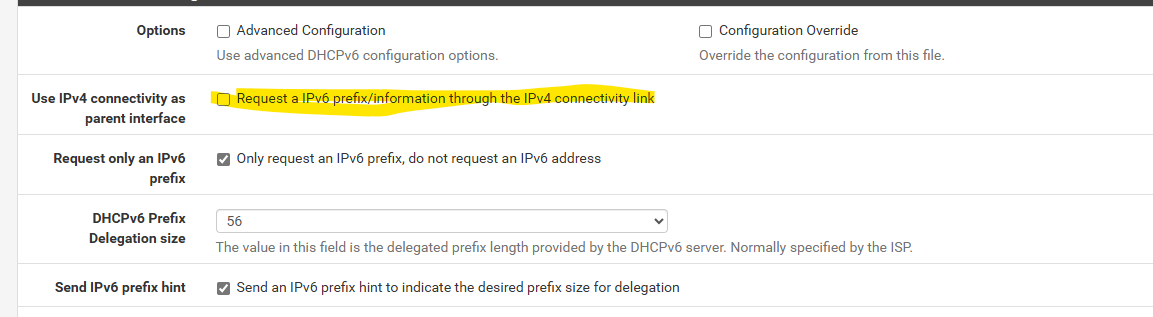

                rvadi @GeorgePatches
                @GeorgePatches
                See the images below, maybe this can help. You could give it a try.
                Thanks!
