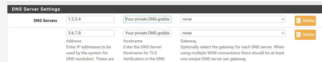

      What is the difference between using DNS resolver with the 'query forwarding' box checked and using DNS forwarder?

          ... and given some DNS servers to forward to :
