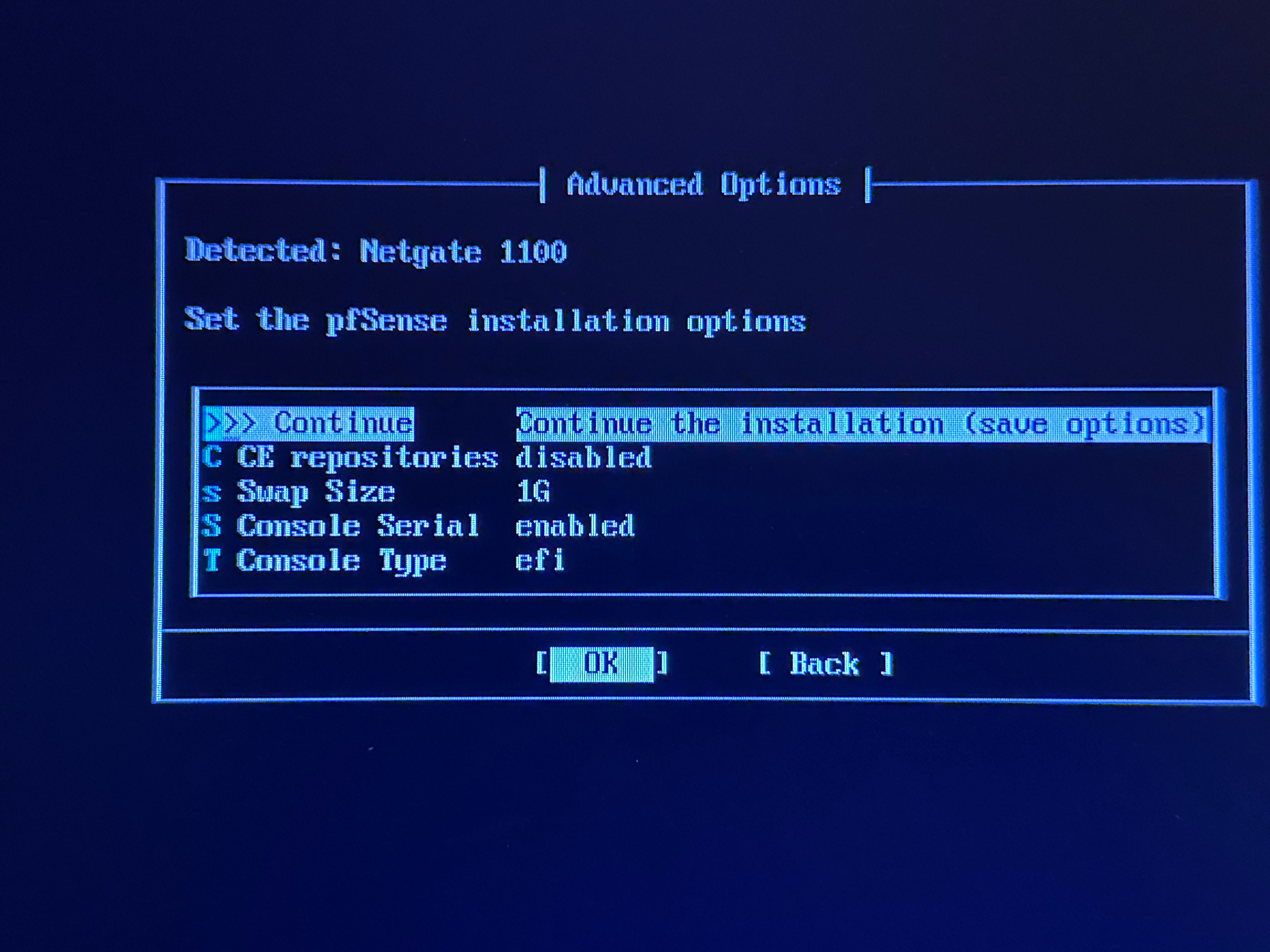

      If I pick Advanced Options, I get this:
      Note there are NO options to load any configuration. I did put the config on one of my USB sticks and put that in the other USB jack. No change.

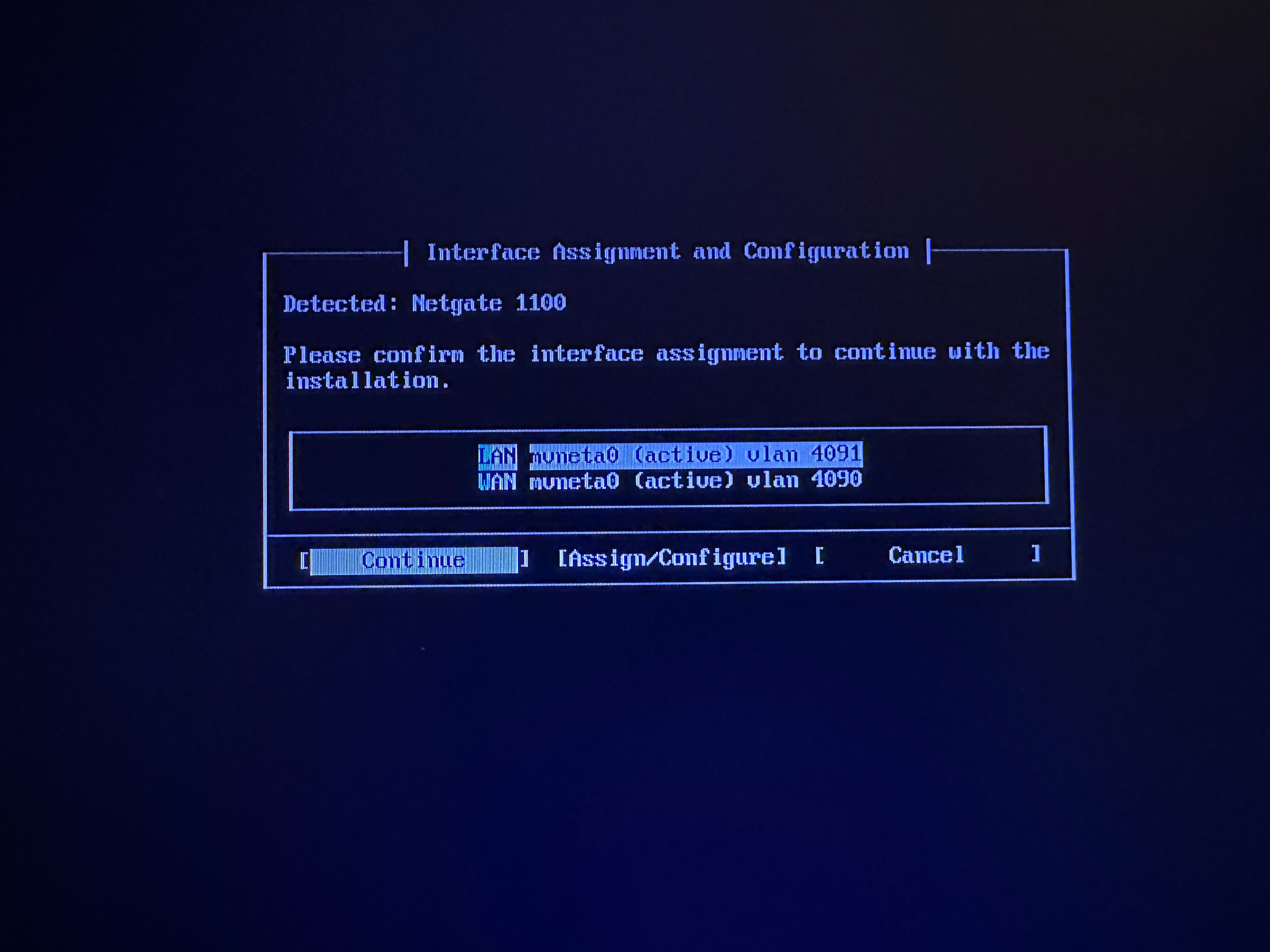

      Then I have to confirm my network connections:
      I did try, due to the info about the address space conflict, to disable the LAN. No change. Next is to get to that point and sludge out to my "Outpost" (on the far end of 1,000 feet of fiber optic cable and 1/0 power cable that I buried in 2' (or deeper) trench and connect to the Starlink wifi to verify it "sees" the SG100. There shouldn't be an issue. In the past I always just connect the SG1100 to the ethernet cable that goes to the fiber optic converters (those are invisible to the network, so just drop that as an issue right now!) and it gets an IP address from Starlink's DHCP and it connects without anything else for me to do.
      So now I'm stuck with the SG1100 not being able to connect to Netgate servers.

        ... disable the LAN ...
        You need LAN, you can't disable it

        I can't specify a LAN address space or anything like that. I'm not anywhere near being able to do that.
        The config of the LAN comes later, after the screenshots you made: https://docs.netgate.com/pfsense/en/latest/install/install-walkthrough.html#select-lan-interface
          It offers the choice to disable the LAN. Since there could be an address space conflict (Starlink uses the 192.168.1.xxx space and pfSense defaults to using that for the LAN), I figured it was worth a try.
          @patient0 said in SG-1100 Won’t Reboot on Upgrade - no internet access!:
          Exactly! So when you were quoting about disabling or changing the LAN address space, I was pointing out that I'm nowhere near being able to do anything like that.

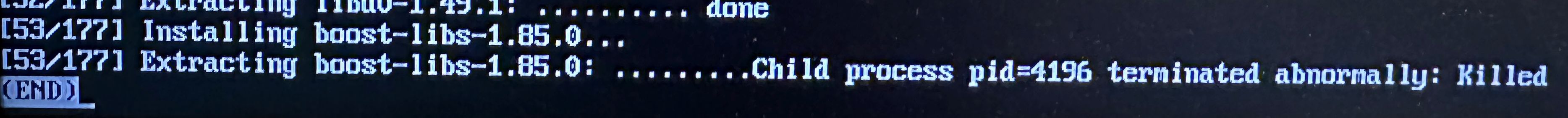

                  Okay, so it started downloading and extracting all the packages, then I got this - well, I can't upload the image. Says it's too big - but I've been uploading all day. Anyway, the last couple lines are:
                  I'm wondering if the same thing could have gone wrong when I was upgrading.
                  Also, I thought, "It's working now, I'll just retry and, instead of uploading the current version (I think it was 24.11), I'll upload the previous version. I think it was during an upgrade to this same version that it died in the first place.
                  Anyway, I tried to reinstall and ran into the same issue: Even with nothing plugged into the LAN connector and with the LAN disabled, I was still getting the problem with reaching the servers. So I think it was just luck I got through that one time.

                    And to stress again: WAN and LAN can not have the same IP range. That is like having a block of flats and two flats have the exact same flat number. The postman wouldn't know where to deliver the packages for that flat number.
                    so it started downloading and extracting all the packages, then I got this ...
                    What was the text next to "... terminated abnormally: Killed" ...? Maybe @stephenw10 has seen that before? It can't be not enought storage since the internal storage was wiped with usbrecovery.
                      [53/177] Extracting boost-libs-1.85.0: .........Child process pid=4196 termined abnormally: Killed

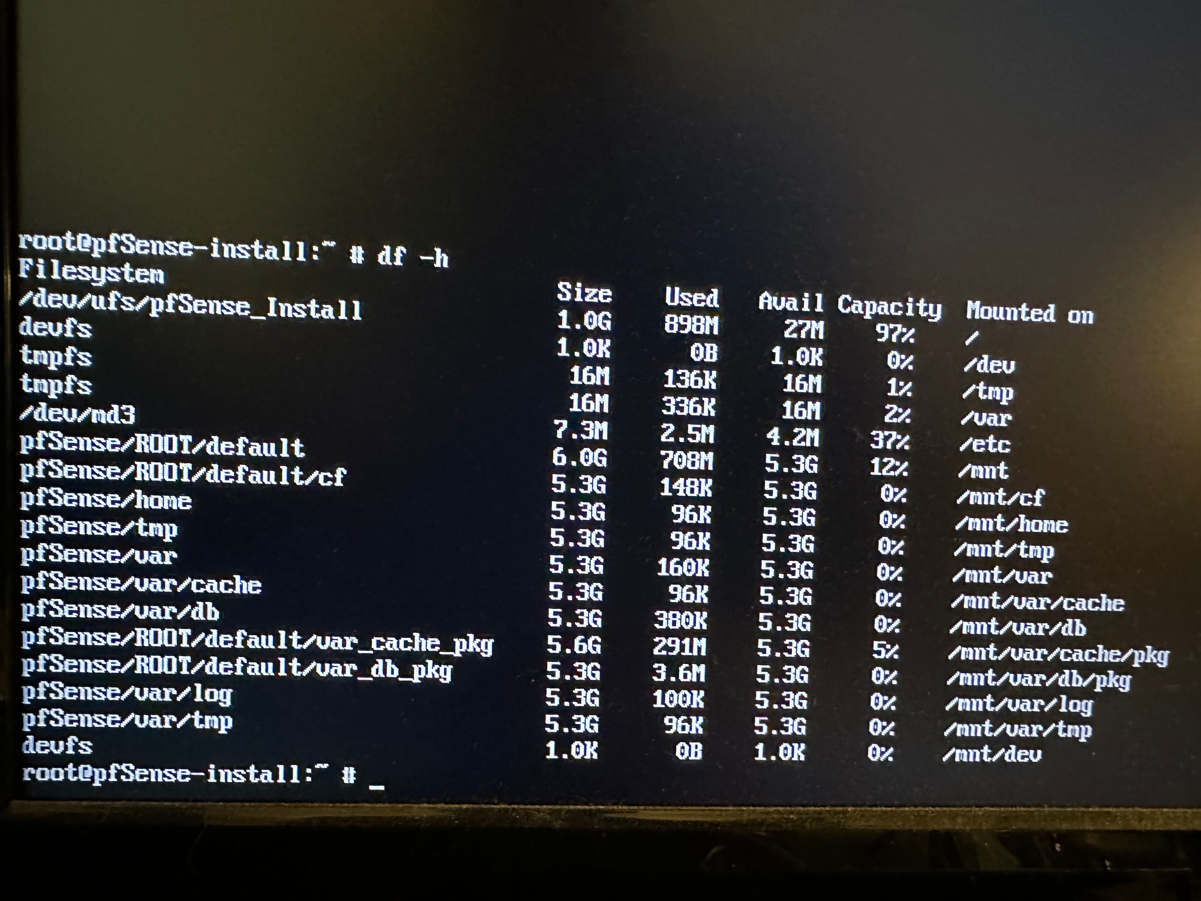

                      I'd like to know where it extracts the packages as part of the install process. If it's treating the USB install drive as the main drive, then it could be extracting them to there. I'm going to try with a bigger drive. But the fact that it crashes on that line with both versions I've tried makes me think there's either an issue with the archive or there's a storage issue.

                          Since it was extracting, I thought there might be an issue with the amount of space available
                          That could have been an issue the first time, yes. But since run usbrecovery is formating the drive that can not be it anymore.
                          Nope, that wouldn't work because the USB drive can be too small. It will extract them onto the target device. But 'terminated abnormally: Killed' doesn't sound like a storage issue but a operating system issue somehow.

                                            One thing that may or may not be worth noting: I tried installing the image (with Etcher) on a larger USB stick and found that the drive size was always the same no matter what. (If I recall, 64GB?). I checked and the fs was FAT, so I formatted at 128GB stick as FAT, with the same name as the installer volume. Then I copied all the files from the stick that was working to the larger volume. It worked on the SG1100 and that was the first time the install went through properly.
                                            So when it fetches, it stores the compacted file on the system drive and when it extracts it, it extracts to the system's drive - and NOT to the USB drive? See my comment just above my response to you. It could be coincidence, but the time it FINALLY installed was when I created my own 128GB USB stick and put the installer on there. I'm wondering if that made the difference. Since it always failed during an extraction, it made me think drive space could be an issue.
