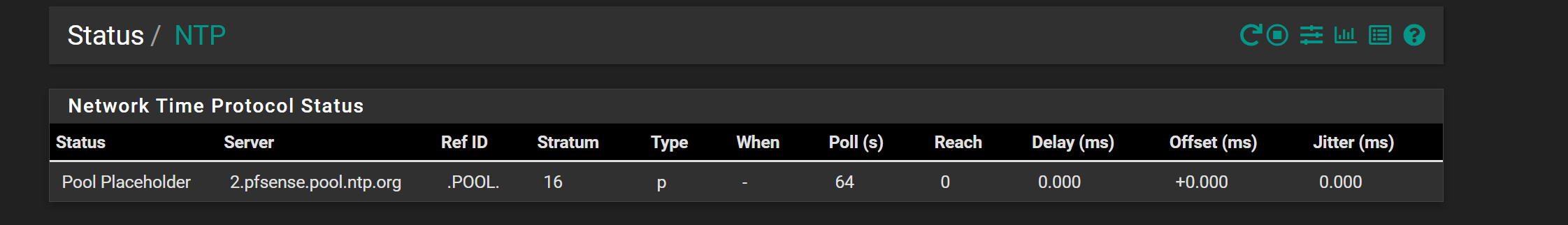

          • Z Offline
            zara @Gertjan
            @Gertjan
            I'm using 2.7.2, my time is not correcte it's trange 8b38f50f-97c4-4989-b734-37c4307ee938-image.png
            but I can not fixe it
            thanks for you help!
              Try just setting the time at the CLI directly. You're probably in a chicken/egg scenario where it cant resolve the time servers because DNSSec is enabled.
              [25.03-RC][admin@8200-2.stevew.lan]/root: date 2502211741
              Fri Feb 21 17:41:00 GMT 2025
              Z 1 Reply Last reply Reply Quote 0

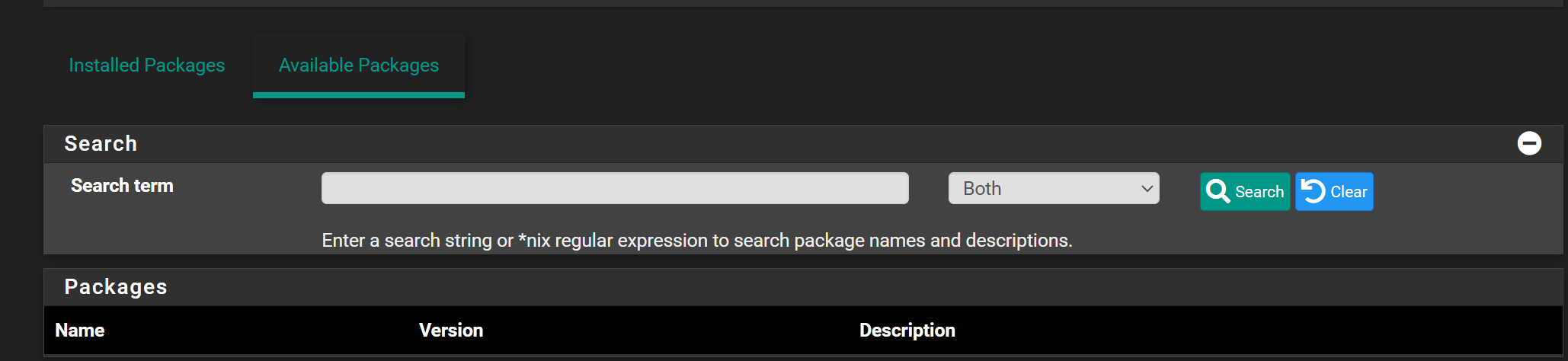

              • Z Offline
                zara @stephenw10
                after change it manually, the problem of CA is gone but I can not install any package. the list is empty
                from cli:
                Enter an option: 13
                pfSense-repoc-static: failed to fetch the repo data
                failed to read the repo data.
                failed to update the repository settings!!!
                when reboot the pfsense my time is set again to ... 2030 it's strange
