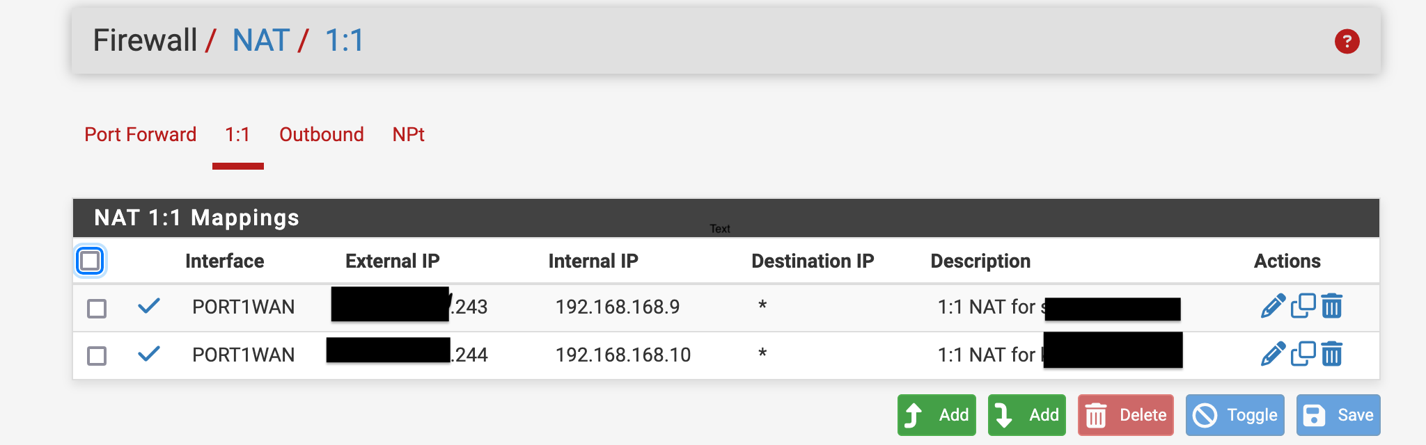

                          Here's my 1:1 NAT assignments for two machines that are mail servers exposed to the outside internet:

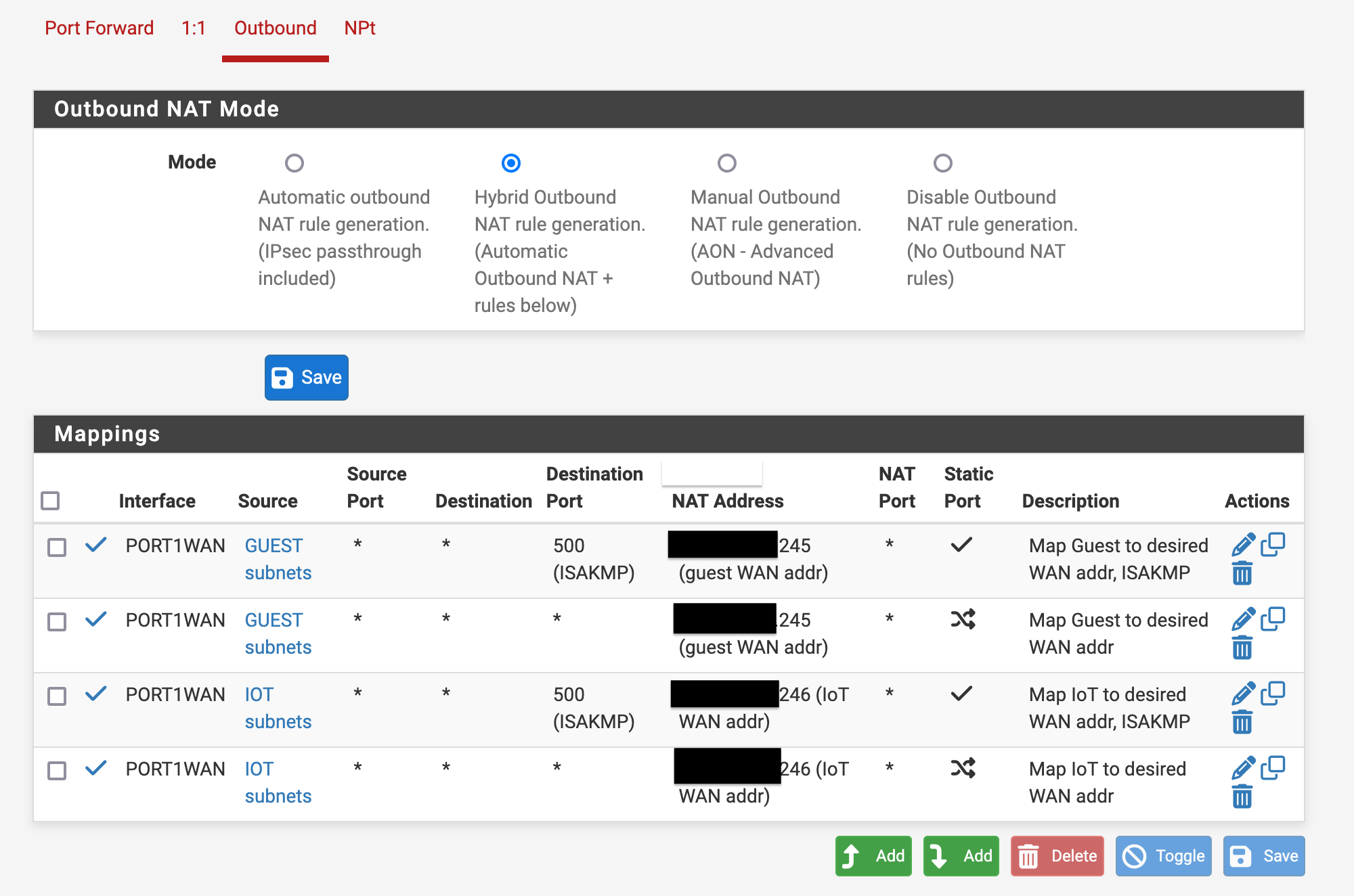

                          Here's my Outbound-NAT assignments for two VLANs whose purposes should be self-evident:
                          The VLANs were set up according to the directions in the pfSense documentation (actually, all of this is in the documentation, once you find it). I do not remember why there are special rules for port 500 --- I think I copied that from a documentation example. For the purposes of these NAT rules, it doesn't much matter that those are VLANs, only that there's an identifiable range of local addresses that are to share the WAN address.
                          In addition to the four WAN addresses you can see being mapped here, I own xxx.xxx.xxx.242, which is set up as the assigned WAN address for PORT1WAN in the Interfaces menu. That carries traffic from all local machines that aren't either the two mail servers or the stuff on the VLANs.
                          Don't forget to add suitable firewall rules to block any connections you don't want. The firewall rules are applied after NAT mapping, so write them in terms of the internal addresses not the WAN addresses.

                            port 500: https://docs.netgate.com/pfsense/en/latest/nat/outbound.html#static-port
