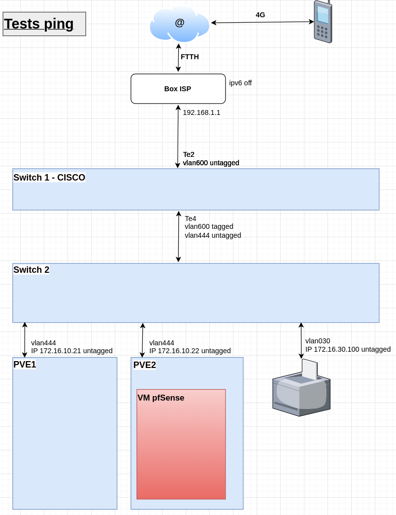

      Hello,
      I am testing a configuration in Homelab environment using Proxmox PVE + pfsense.
      1. Main points
      • pfsense is behind an ISP's box, on Proxmox's VM.
      • ISP's box redirect all traffic -> pfsense WAN (using DMZ)
      • PVE has a single NIC.
      • Traffic separation is done via vlans :
        -> Internet is on vlan600
        -> Proxmox are on vlan444
        -> printer is on vlan30
      2. From vlans -> Internet
      ->Everything is normal.
      3. From Internet -> vlans using external wired connection
      -> I can't ping anything, it's OK.
      4. From Internet -> vlans using 4G Android mobile at home and Termux app
      -> I can ping devices like printer, PVE1, etc...
      -> I double checked, my phone was on 4G mode (WIFI off).
      I dont' understand :
      • How a non routable adress like 172.16.30.100 can be ping through Internet without vpn.
      • 4G ping is coming from fiber ISP, then ping should be KO like a ping from another external box.
      Did I missed something ?
      Could you please help me explain and correct this behavior ?
      Thanks !

        @dvb said in Strange behaviour with pfSense and 4G:
        There is no way any outside IP can ping your local devices, either through your ISP router or pfsense. Your mobile ISP would have no clue where to route such a request...
        I think there is only one explanation... that the phone is actually connected to the 172.16.10.1/24 network.
        Either you have some VPN/Tailscale running which can connect it to your LAN. Or it is in fact actually on wifi although you think it's off.
        Or perhaps another explanation is that the mobile ISP is using 172.16.NN subnet for their mobile clients and you are pinging someone elses phone or tablet... Check your IP on the phone...

          @Gblenn said in Strange behaviour with pfSense and 4G:
          I agree with you, because these are non routable IP adresses.
          Even though I didn't detect anything, this seems the most logical.
          This hypothesis is not possible because I could ping only my devices. And I just checked again, my phone IP is on a different range : 92.184.x.y
          I didn't indicate it, because I uninstalled the server in the meantime, but I did some tests with OpenVPN. Even if it seems impossible to me, it gives the impression of a persistence of the tunnel
          Anyway, I just checked and everything is back to normal.
          Thank you for looking into this situation !
