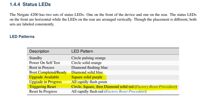

      The manual doesn't reference this:
      I have 6 Netgate 4200 max devices, and only 1 of them is doing this. All boot fine and seems to run perfectly.
      5 of the 6 boot to a blue light on the diamond.
      However, I have one that boots to a Green Square and a Blue Diamond. What does a green led on square mean and why does this one device act differently?
      Thanks
      Mike
        Hmm. It doesn't mean anything specific. Green is only actively used during upgrade as shown there.
        Does it still do it after a full power cycle? It could be the green LED not having been cleared after an upgrade perhaps.
