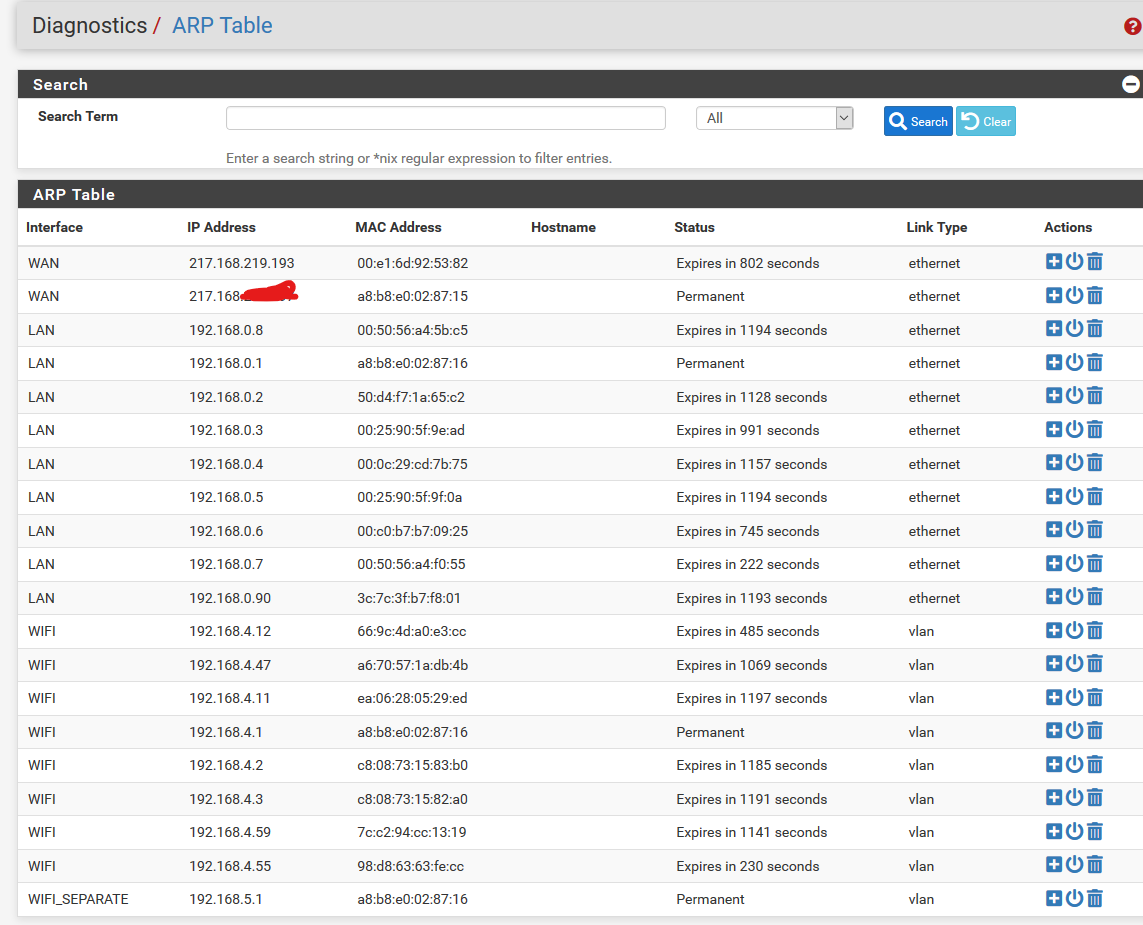

              @Octopuss I have noticed another thing after I had a complete internet disconnect,
              First of all, I have no idea what "ARP table" is, but at the top of the list, there were two entries, the top one being the IP of the ISP's AP few hundred metres away, and the 2nd is actually our public IP.
              When I manually removed the top one, the connection was instantly restored.

                The top entry there is the upstream ISP gateway address. That is somewhere in the ISP network, the next logical hop, but almost certainly not the actual wireless device.
                @Octopuss said in Weird internet disconnects and suspicious stuff in the log:
                There are no other devices, there cannot be. The path is literally ISP's AP-air-antenna on the roof-cable-our router.
                Why do you think there could not be some other client in the WAN subnet? If you're lucky the ISP might have some sort of client isolation enabled in their wireless device but they might not. It would only take some other customer to typo the IP they are supposed to be using.

                      And from the other logs I can see the unbound service seems to be stopping and starting all the time, but that's probably irrelevant. I don't understand any of this.
                      • stephenw10S
                        Something else in the WAN subnet using your IP address is a massive problem! That's going to break connectivity for you (and them). There's really no point investigating anything else whilst that is still present IMO.
                        If you can speak to the ISP I would tell them this is happening and see what they say. Most likely some other customer has typo'd the IP address. Or tried to just use another IP.
                        O 1 Reply Last reply Reply Quote 0
                        • O
                          Octopuss @stephenw10
                          @stephenw10 Later yesterday I heard back from one of the guys from the ISP. He told me they found and blocked the MAC address and were investigating WTF was going on. I hope they will let me know.
                          It clearly was something inside the local wireless clients segment, but I can't imagine any possible cause aside from someone setting our IP address by mistake, but that makes little sense as well because that would likely be a permanent conflict and not something that happens repeatedly in semi-random interval of 30mins to 2 hours. It could have been something malicious but I cannot imagine any scenario there.
                          • stephenw10S
                            Hanlon's Razor applies here. 😉
                            It was probably just a mistake somewhere. Or perhaps some client thought they could just add more IPs to use and it wouldn't matter. If they didn't use them all the time that might explain it.
                            Anyway let us know if you still see any issues now that can't happen.
