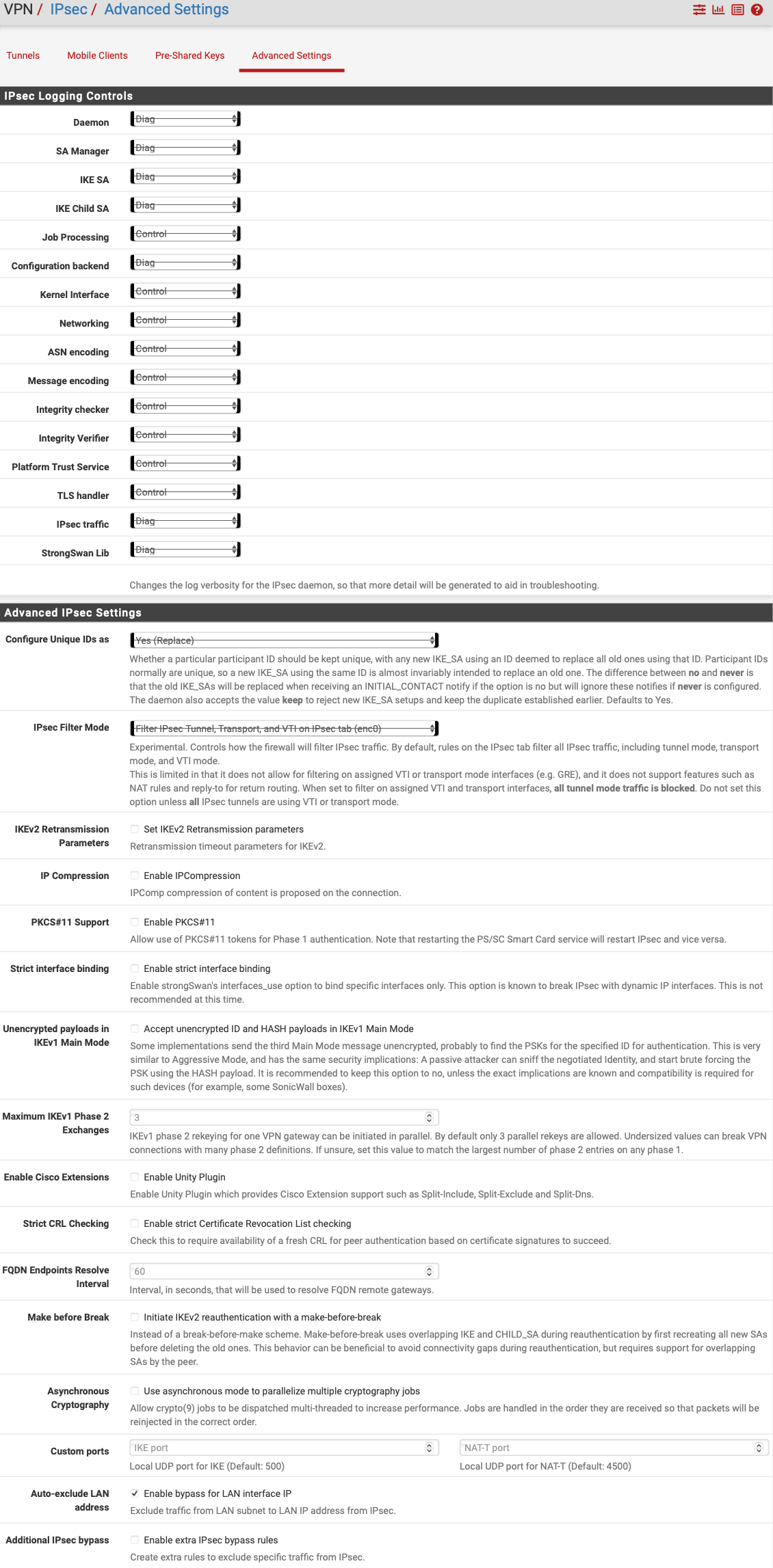

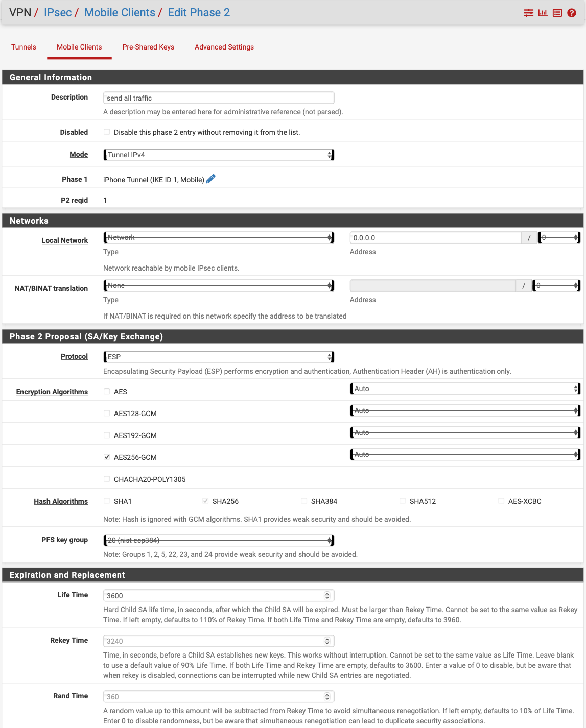

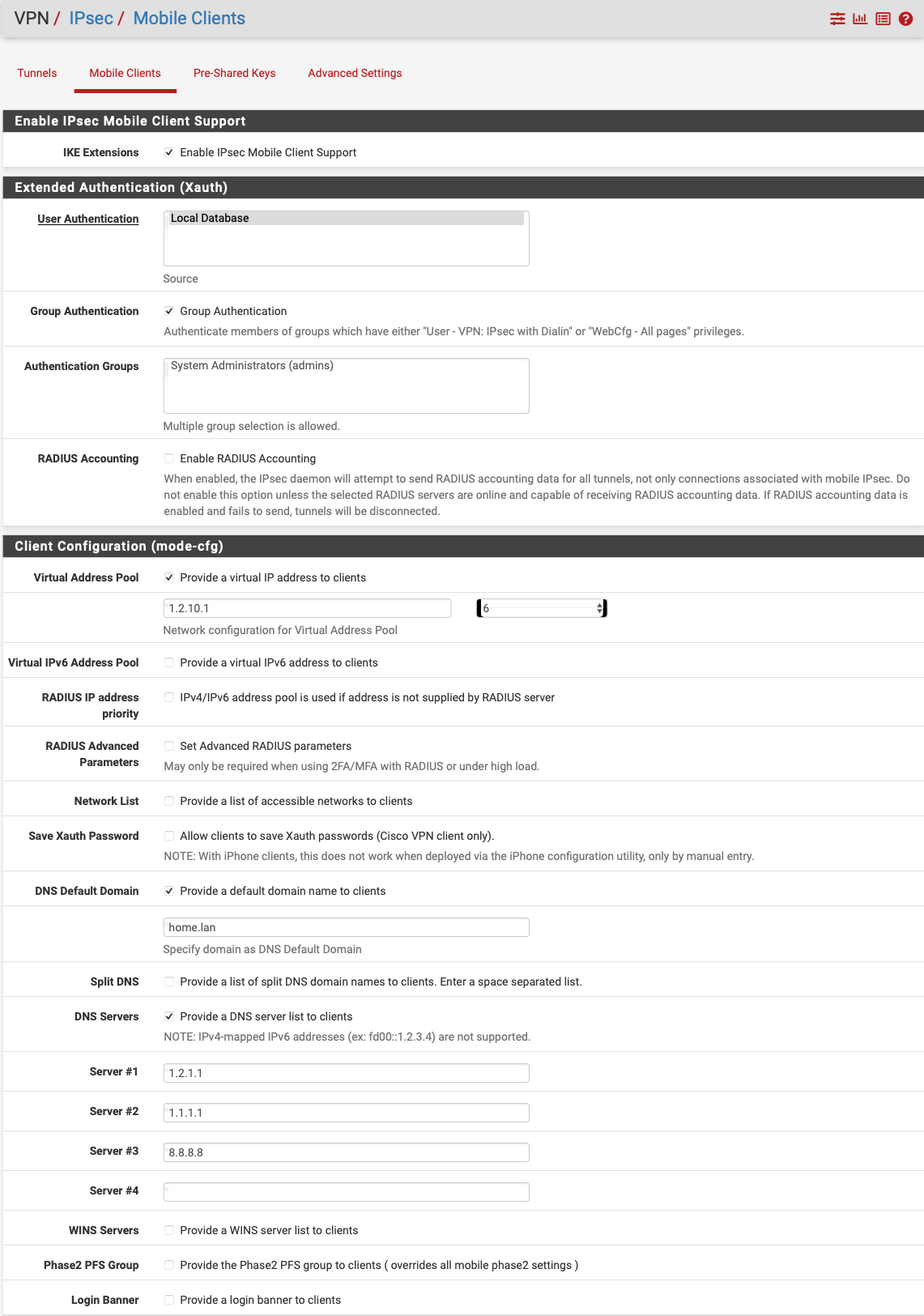

            I think its tunnel because I set it up years ago. Have no idea what VTI is but think its new. The VPN settings are (any IPs changed for security):
            pfSense.lan - VPN: IPsec: Mobile Clients: Edit Phase 1.jpg
            pfSense.lan - VPN: IPsec: Mobile Clients: Edit Phase 2.png
            pfSense.lan - VPN: IPsec: Mobile Clients.png
            pfSense.lan - VPN: IPsec: Advanced Settings.png

                Ok the problem is almost certainly that the address pool you're using for mobile clients is 1.2.10.1/6.
                That's all addresses from 0.0.0.0 to 3.255.255.254 and those are public IPs. Since the local side is set to 0.0.0.0/0 (any address) it means that the tunnel will match any traffic trying to reach any public IP in that range. So I suspect a lot would be broken but you have just now noticed it because the VoIP server is probably in that range?
                Unclear why 2.6 would not be affected but probably more luck that anything. It likely should have been and only isn't because of a bug which is fixed in 2.7.2.
                So set the pool to some much smaller and private subnet like 10.2.10.1/24. Assuming that doesn't conflict with any local subnet you have already.
                  MarioG
                  Holly mackerel you nailed it! When I set it up years ago I thought the 6 was the number of clients (no mask title), that's why I made it 6. I changed it to 24 and bingo all was well again! Also, the real pool address is different, I changed the post to 1.2.10... for privacy. It's actually 10.246...., no matter since changing the mask to 24 fixed it. I guess it was probably was a 2.6 bug as you said.
