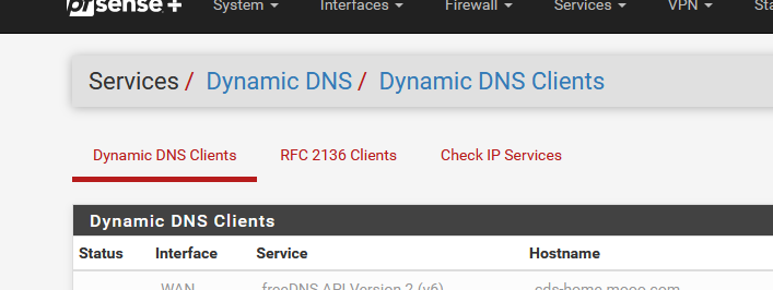

        @Gertjan said in [solved] Easy solution for logging my daily changing WAN-address:
        Doesn't exist anymore
        Or how to do it with the DDNS-thingy.

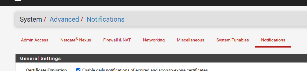

                                        Gertjan @jrey
                                        @jrey (Bob) said in Logging my daily changing WAN-address:
                                        Is there a package where I can log only my dynamic IP-address on WAN?
                                        World's most simple solution : your mail box. This means you have the WAN IP thus a possible remote access possible where ever your are.
                                        The setup :
                                        Set one up here :
                                        and set up this :
                                        and done.
                                        edit : no script, no maintenance.
