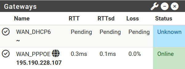

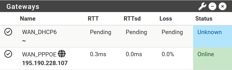

        @RobbieTT I've posted my issues over in the reddit forum but I'm not sure its been picked up.
        If you go to Status-> Interfaces - then Disconnect the WAN interface to drop the PPPoE, then refresh the page to get the button to change to Connect, then Connect, does it reconnect? I only get every other connection attempt work, every other one stalls saying its "UP" but no Gateways or connectivity is established, I need to drop and then reconnect again. It's fine switching back to the original PPPoE.
        Also the IPv6 Gateway doesn't always start monitoring correctly, and shows status Unknown, but there is IPv6 connectivity okay. Going into Gateways and into the IPv6 gateway and disabling monitoring, then saving that, then re-enabling monitoring and it starts monitoring and switches back to online.

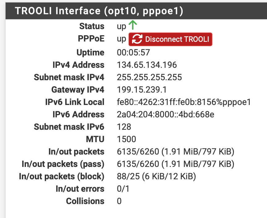

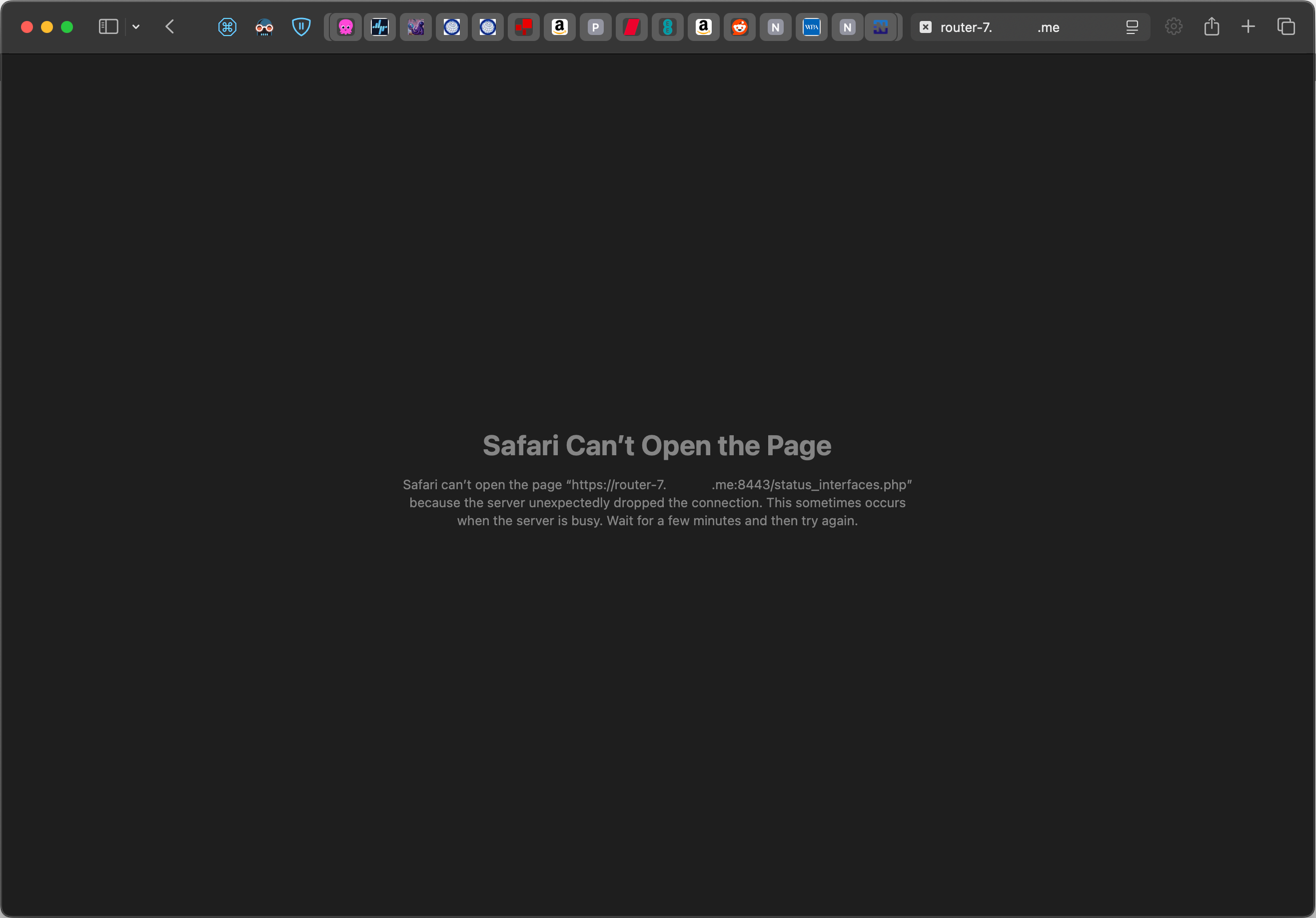

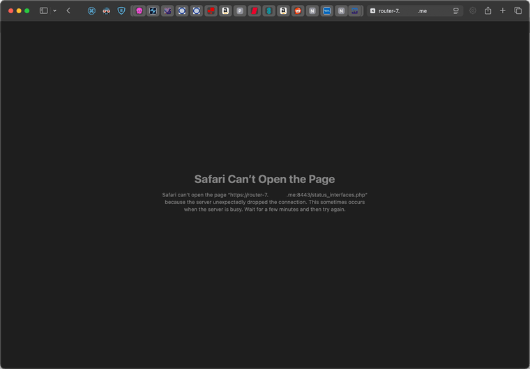

          Regarding the Status / Interfaces / PPPoE interface 'Disconnect' I do experience the exact same issue you describe and pfSense seems to hang after the first state change command (eg Disconnect WAN) and if left alone it fails to recover IPv6 properly. If you repeat the command it seems to all work fine again, including IPv6.
          So that looks like a bug that needs resolving. It may even be linked to the PPP status logs not working, as noted by others.
                I think the connection status you see is actually an artifact of the new interface type. I can sort of replicate what you see but in fact it does connect it's just not instant. You can see what the actual state is using the new pppcfg command.
                When you disconnect the interface in the gui it is removed entirely:
                [2.8.0-BETA][admin@pfsense.fire.box]/root: pppcfg pppoe1
                [2.8.0-BETA][admin@pfsense.fire.box]/root: ifconfig pppoe1
                ifconfig: interface pppoe1 does not exist
                Then as soon as you click connect the interface is created and is shown as UP but the PPP link it still connecting:
                	dev: igb1 svc: BTInfinity state: PADI sent
                	sid: 0x0 PADI retries: 3 PADR retries: 0
                	sppp: phase establish authproto auto authname "bthomehub@btbroadband.com" peerproto auto
                pppoe1: flags=1008851<UP,POINTOPOINT,RUNNING,SIMPLEX,MULTICAST,LOWER_UP> metric 0 mtu 1500
                	description: BT
                	options=0
                	inet6 fe80::201:21ff:fe01:6775%pppoe1 prefixlen 64 tentative scopeid 0x13
                	groups: pppoec
                Then after some time it completes the connection:
                	dev: igb1 svc: BTInfinity state: session
                	sid: 0x1b6d PADI retries: 4 PADR retries: 0 time: 00:00:12
                	sppp: phase network authproto auto authname "bthomehub@btbroadband.com" peerproto auto
                	dns: 81.139.56.100 81.139.57.100
                	description: BT
                	options=0
                	inet 217.45.X.X --> 172.16.13.252 netmask 0xffffffff
                	inet6 fe80::201:21ff:fe01:6775%pppoe1 prefixlen 64 scopeid 0x13
                	groups: pppoec
                	nd6 options=123<PERFORMNUD,ACCEPT_RTADV,AUTO_LINKLOCAL,NO_DAD>
                The actual time taken depends how fast the server responds. For be that be almost instant or it can be several retries and 20-30s.
                If you just refresh the Status page without clicking connect again it should just connect.
                We saw your post on Reddit yesterday and were discussing options to make the age clearer for if_pppoe. Not sure what will happen yet.
                RobbieTTR P 3 Replies Last reply Reply Quote 0

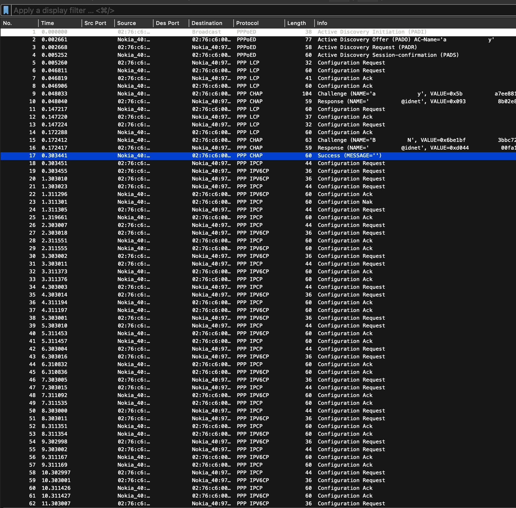

                                  When the GUI 'hangs' for a bit I then get the ever-helpful busy message:
                                  Hopefully the log may be of more help.
                                    Huh, it just returns nothing immediately? Or appears to hang waiting for something?
                                    Returning nothing is what it does when the interface is down, before you click 'connect'. Usually!

                                      As in the SSH connection stalls so nothing to access. I'm not best placed to stick the console cable in etc.
                                      Anything useful in the system log I sent?
                                        Nothing really jumps out. Except maybe the fact you have a 10M USB NIC connected. 😉 Which makes me twitch but probably isn't related.
                                        During that time you disconnected and attempted to reconnect from the Interfaces Status page? And it failed connect?
