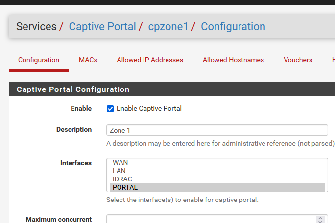

      My pfsense portal is 192.168.24.58. How should I set the portal for the subnet of 172.16.69.0?
        Gertjan @1013215273
        @1013215273 said in How should I set the portal for the other subnet:
        Are you sure ?
        192.168.24.1 or 192.168.24.254 if you have to ... but a gateway IP in de middle of a network .... look strange.
        It isn't wrong by definition.
        Ah, another interface ?
        Create another captive portal that is using this new ( ? ) interface :
        You have to pick it by the interface name you gave it, like "PORTAL".

          @Gertjan Can I open a portal directly for the new subnet 172.16.69.0 using 192.168.24.28 (lan interface) without setting up a new interface (172.16.69.x)

              Gertjan @1013215273
              @1013215273
              Look again at the captive portal settings.
              There are no IPv4 addresses to be set.
              You have to select an interface, like LAN, or, so what I have, PORTAL (was originally OPT1).
              How where why do you want to set "172.16.69.x" ?
              What are you trying to achieve ?
