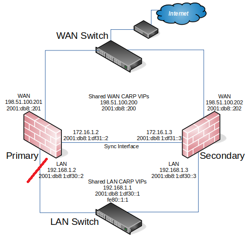

                    Test the HA pair in as many failure scenarios as possible. Additional tests include:
                    • Unplug the WAN or LAN cable --> FAIL

                      If you unplug WAN or LAN on the master it should failover to the backup and make that one master.
                      Could be a lot of reasons; the diagram is from the Netgate doc, how is you setup?
