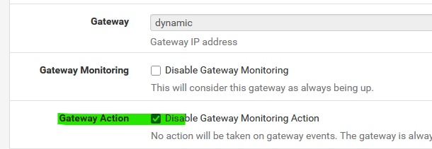

                  Two tests : disable the dpinger action for a while :
                  if the issue goes away : it was dpinger. The issue is still there : the issue is on the other side of the WAN cable.
