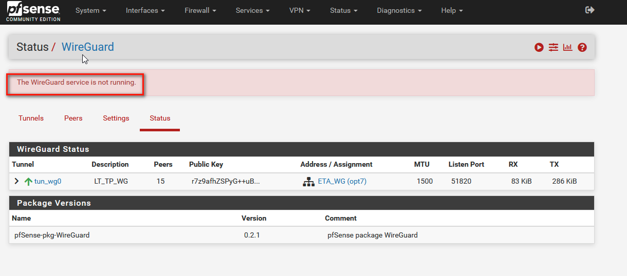

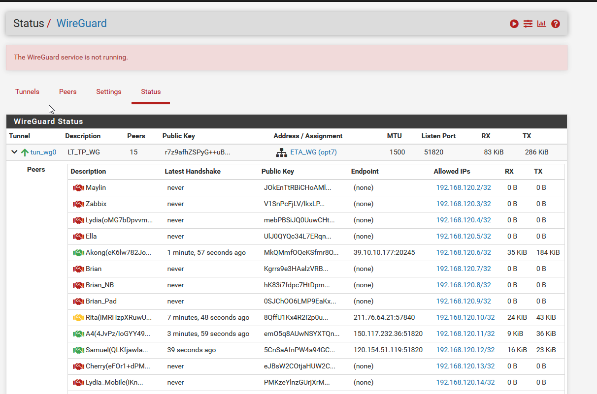

      akong77
      Please see pic
      But I click status have show user connect and I have test connect wireguard it's ok.
      How to fix it?
      I have see log.Just show
      /usr/local/pkg/wireguard/includes/wg_service.inc: Gateway, NONE AVAILABLE
