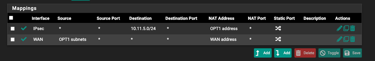

                  So I have the following on the Remote Server where I am pointing the traffic that I want to come into the system from:
                  Firewall Rule:
                  Port Forward Rule:
                  Outbound NAT:
                  And on the local system I have only changed the Firewall > NAT > Outbound to Hybrid and added the following rule:
                  Excuse the different themes I added them so I had a visual clue to which box I was working on to stop me getting confused.
                  The port still doesn't seem to be accessible do I need to add another rule in or have I not setup the NAT correctly?
                  /Stan

                    viragomann @stan.fergusonsmith
                    @stan-fergusonsmith
                    Does your application really use a static source port?? That's very unusual.
                    Most application use a random source port. So you probably have to set the source port to 'any' in the port forwarding and firewall rule.
                    • S
                      stan.fergusonsmith @viragomann
                      @viragomann thank you!
                      You were right I was being an idiot! All working now as it should be.
                      Thank you very much for your time and patience
