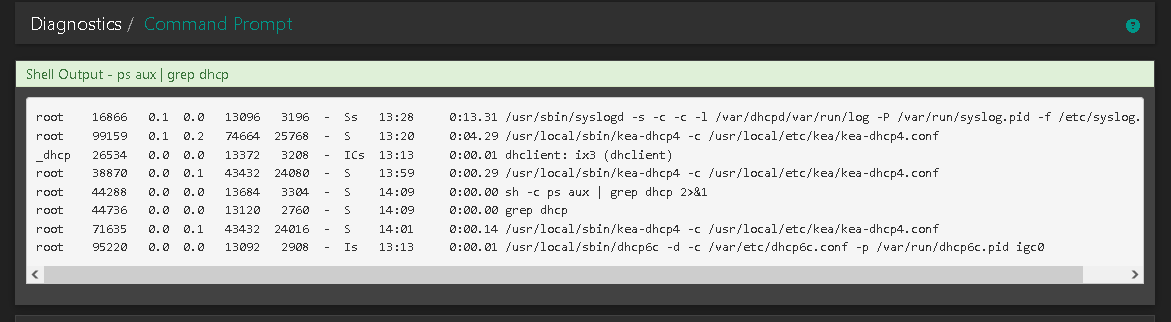

              I have multiple KEA DHCP instances running. What issues could this cause?
              patient0P GertjanG 2 Replies Last reply Reply Quote 0

                @smsigroupit said in Issue with pfSense DHCP Lease Status Display:
                I'm not sure why unfortunately, can you stop KEA from the GUI and check if there are still KEA process running? I assume you will still have some running and will cause an issue.
                You can then either manually kill the leftover KEA processes or restart pfSense. I'd prefer restart, just to make sure that after a reboot only one KEA instance is running.
                    Ok, you've found the issue.
                    You've use the (not so) magic console command. Way better as whatever a GUI can show you.
                    The solution :
                    Say goodbye to the Diagnostics > Command Prompt because ... its GUI based.
                    Activate the SSH access (and if your pfSEnse is nearby, the console access is also usable)
                    Use a SSH or 'serial com' client (Microsoft : get Putty for example).
                    Ones in, menu option 8, and kill all dhcpd processes.
                    Not the dhcp6c & dhcpc as these are the DHCP client daemons as these are for your WAN.
                    Kill al the 'kea' stuff.
                    Then :
                    service kea onestart
                    or use the GUI : go to the DHCP server page(s) and Save the config. This will restart the DHCP server(s).
                    The DHCP leases file wasn't updated with the new leases as it was 'opened' by the other 'hidden' DHCP kea process, so it was locked / not accessible by the DHCP server that delivers the actual leases.
