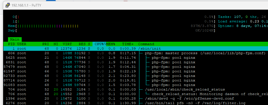

          When you suspect an issue like a slow down, use the interface that's light weight : use the 4100 console access, or, if you are further away as 1 m. (3 "feet" - don't ask me what the feet size is, they are all different) use the SSH access.
          Use Option 8, and type :
          top
          You can sort the columns on "WCPU" and this shows you the most CPU bound processes at the top.
          You find one that uses "all" (like 99%) all cycles all the time .... kill it with the kill command.
