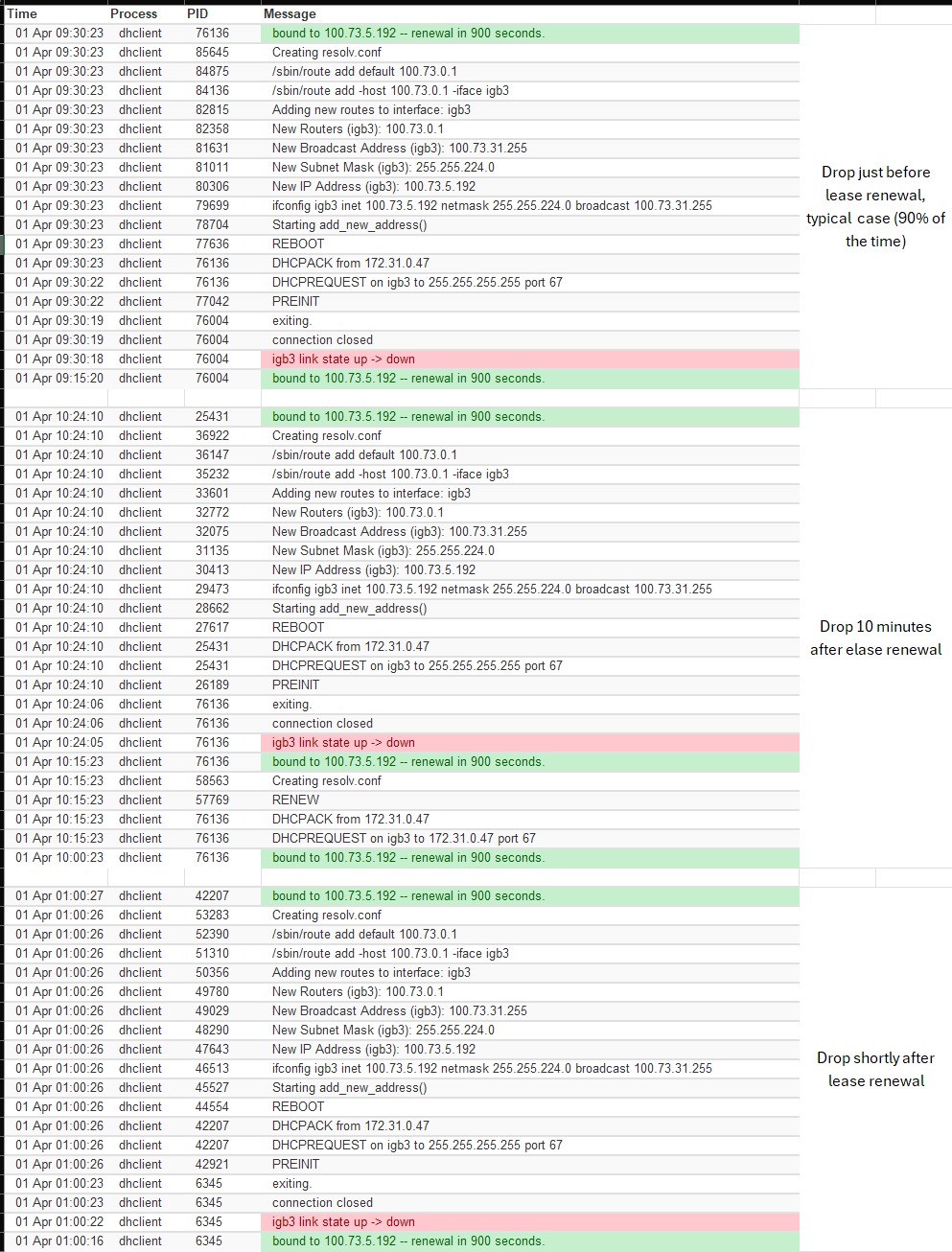

Usually very close (within seconds) to DHCP lease renewal T1, the link between the ISP and firewall drops for a couple of seconds. This has also happened at other random times, but usually close to T1. I have confirmed this with camera surveillance footage showing the link light go out when the link down message appears in the log.What I have tried:

Attached is the DHCP log from PfSense.

Compare side by side the DHCP log and the system log at the same moment.
In the system log, are there any 'dpinger' (WAN monitoring) packet loss messages ?@Andy142 said in Seemingly random ethernet link drops, usually at DHCP lease T1:

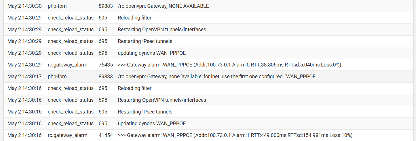

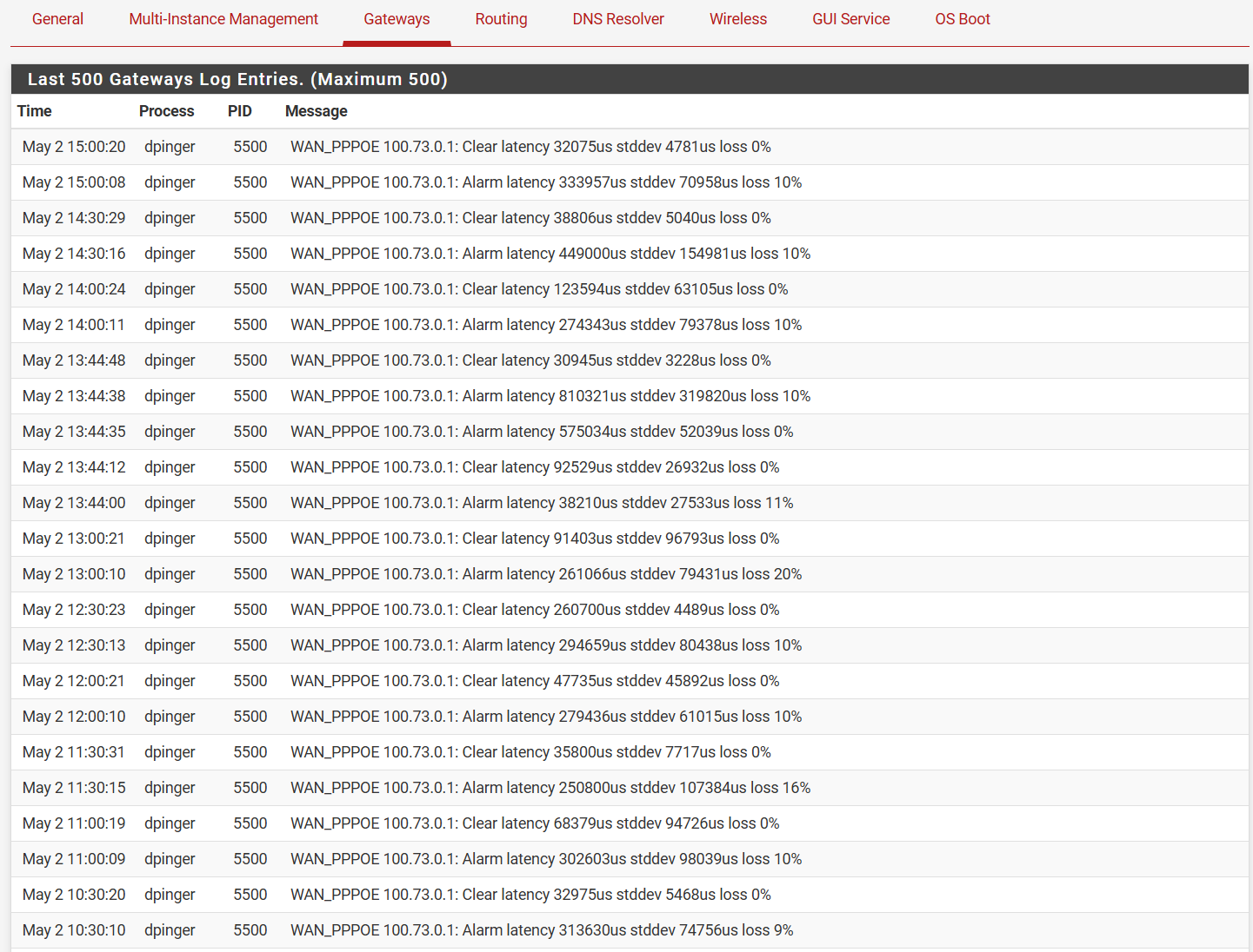

Gateway Log:
System Log:

If its a router type, I would consider that behavior as 'not normal'.Like a clock : every 30 minutes sharp you the connection drops packets (== the monitor pings ), to re establish 10 a 20 seconds later.

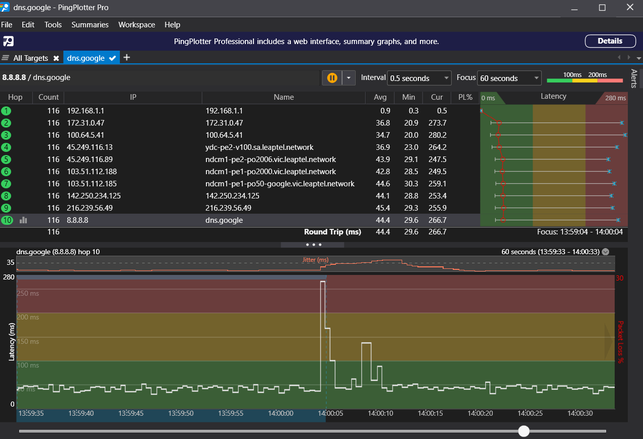

ISP asked me to take some logs using pingPlotter. You can see a significant lag spike at hop 2.
Something missing : your avaible bandwidth.
After all, what happens with ICMP packets when the upstream or downstream "pipe" is full ? They get discard. And that shows up as a rising latency, or even packet loss, and it looks like the connection went 'bad'.
But its none of all this : it just queuing = delays. -

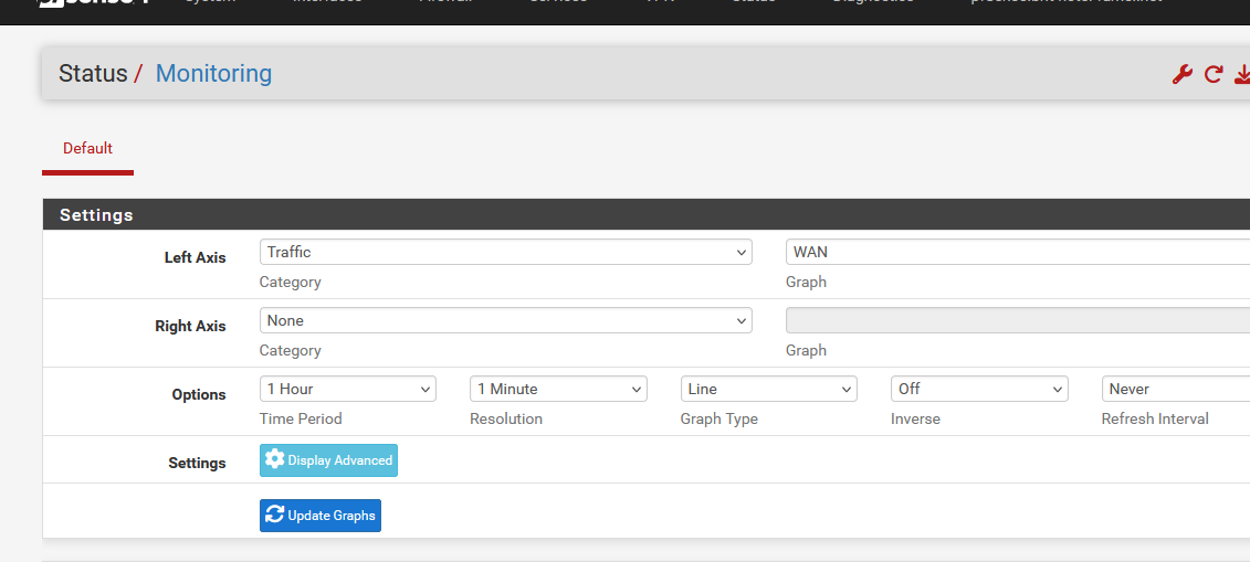

And your devices ? When a PC decides to upgrade to the last 2H24, or your phone has the newest OS version avaible, it won't ask you for permission, it just starts downloading.pfSense can show you what happened when :
If no traffic goes ever the WAN at the moment latency started to rise, then ... well, be ready to "never have the answer".
