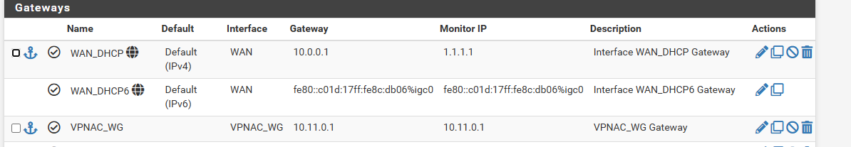

My bloody ISP assigns me a CGNAT ip in the 10.0.0.0/8 range with gateway IP of 10.0.0.1.My wireguard settings I got from my privacy VPN provider is also in that range.
Wireguard gateway 10.11.0.1
with static ipv4 10.11.3.37/16Though, I am not an expert, looking at the crash dump, I suspect this is crashing my pfsense instance.
Am I correct to assume as such? How can I prevent this?
Crash dump attached. -
@Laxarus What ISP, what VPN Provider and show Status/Interfaces for WAN.
@Bob-Dig It is an obscure ISP called STC
VPN provider: VPN.AC

Umm, your ISP gives you a /8 subnet on WAN?! That's.... a new level of fail. Even for an ISP!
There's a specific range for CGN and it isn't in 10/8.
But it still shouldn't cause a crash. Routing problems perhaps.
