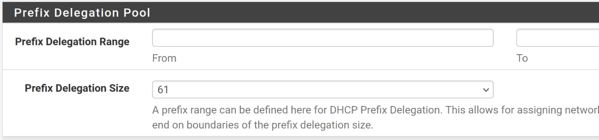

        Based on the Cisco doc I linked, it looks like they use DHCPv6 only. I don't see anything about RAs. Then on the switch VLAN interfaces, I setup RAs (managed?) and DHCPv6 using the prefix-from-pfSense and a "static IP" (prefix + /64 subnet ID). But the question I have still remains. How do I hand out a /61 to the downstream Cisco CORE switch? I'm looking at the DHCPv6 Server config in pfSense 2.7.2, and I'm seeing:
        If I'm understanding IPv6 "subnetting" correctly, a /61 gives me eight /64 subnets. With the screenshot above, how do I define that I want the 0-7 subnets and not 8-f? Do I also keep the "Prefix Delegation Size" at 61? The documentation around these fields is not very descriptive. Thanks!!

              @JKnott I think that only applies if the interface I need to address is on pfSense. My situation is that I have a transit network between pfSense and a dowstream L3 switch. The L3 switch has all the VLAN interfaces on it and performs the routing. There's an OSPF adjacency between pfSense and that L3 switch so each subnet knows how to talk to each other and the internet (via pfSense). So as I said, on my pfSense box, I have the following interfaces and their associated IPv6 subnet (/60 gives me sixteen /64s, labeled 0-F):
              Home Automation (D)
              Guest (E)
              OpenVPN & Wireguard (F)
              Transit (0)
              Then on the 3850 L3 switch, I have these VLAN interfaces and what I'd like to be their IPv6 PD ranges:
              Transit to pfSense (0)
              MGMT to ACC switch (1)
              WiredLAN (2)
              VoIP (3)
              WirelessLAN (4)
              Media (5)
              Server (6)
              So I need to know how to get those PD subnets advertised to the L3 switch across the transit network. I hope this helps, and I appreciate the responses!!

                  It sounds like you're agreeing with me that I need to "tell the switch what prefixes are available." I'm asking how do I do that. I'm assuming from pfSense > Services > DHCPv6 Server. In the screenshot I provided, I don't know what to put in the PREFIX DELEGATION "FROM" and "TO" fields. I've tried:
                  ::0/61 ::7/61
                  :0::0/61 :7:ffff:ffff:ffff:ffff/61
                  and others
                  I can't seem to figure out what to enter in these fields. I think these fields would distribute the PDs that are available to the L3 switch (Xfinity PD 0-7). Do you or anyone else know? Thanks!

                    So this might be the answer. Since I want to assign a /61 with 0 as the starting address and 7 as the ending, I put in:
                    From:
                    ::0
                    To:
                    ::0
                    Prefix Delegation Size: /61
                    I was able to save with no issues. Hopefully tomorrow I'll get to see if the switch likes that.

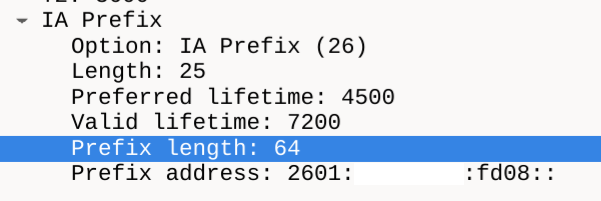

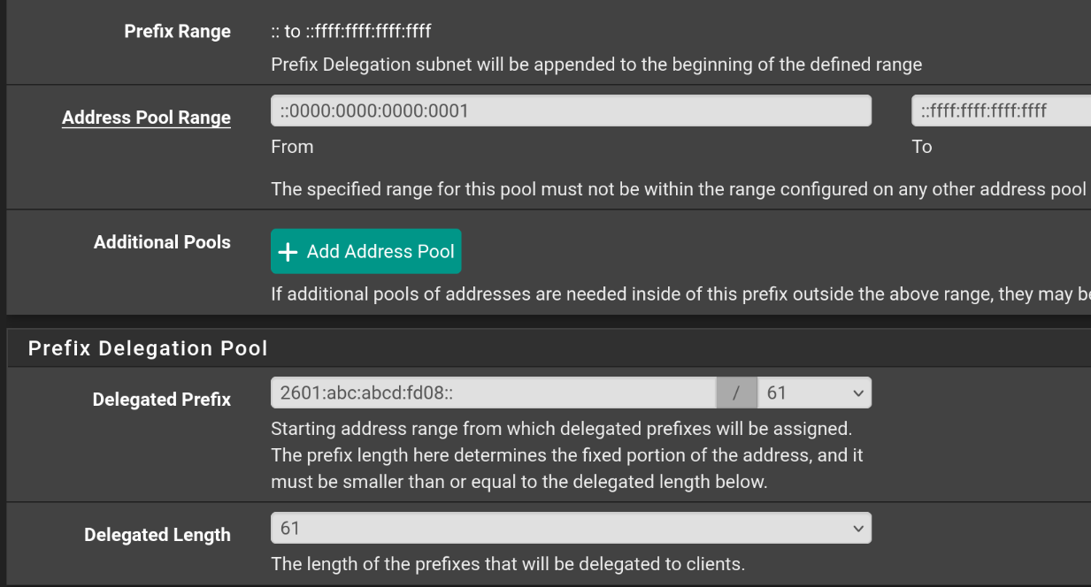

                        I got caught up in work and dropped this for a while. I'm back now and I've made a little progress. Xfinity / Comcast is give me a /60 (16 /64 subnets). I have the LAN interface tracking WAN using hex 0. This gives my LAN the address of 2601:abc:abcd:fd00:a236:9fff:fef2:383a . This is the last 0 in fd00. I want to pass down to my layer 3 switch a /61 to split among the other VLANs/subnets on that switch. FYI, the L3 switch is the only device on that VLAN. In pfSense, I've changed to the KEA DHCP backend. In SERVICES > DHCPv6 SERVER, on the LAN interface, I see:
                        PRIMARY ADDRESS POOL:
                        PREFIX: Delegated Prefix: WAN/0 (2601:0abc:abcd:fd00::/64)/64
                        72bc82e2-4a51-4a05-be4b-ec46d865e660-Screenshot From 2025-11-17 18-00-07.png
                        In PREFIX DELEGATION POOL I'm trying to serve out a /61 (which should be 8 /64 subnets) to the downstream layer 3 switch. I ran a packet capture on the LAN interface and cleared out the IPV6 DHCP client on that VLAN/LAN interface. It looks like pfSense is only sending a single /64 address.
                        07003cd3-c7c3-470a-be07-c4097fc66713-Screenshot From 2025-11-17 18-06-47-sanitized.png
                        I'm not sure where to go from here. I think I've got the DHCP server configured correctly. Does anyone have any thoughts on this? Thanks!
