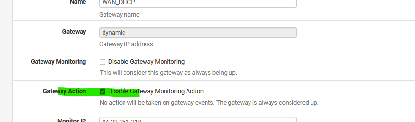

For example, for the WAN interface, a ping process sends a "ping" every xxxx ms and wants a reply bad. If nothing comes back, this ping process will 'toggle" or reset the WAN interface. This might re establish the connect, but most often, because a phone line (fibre, radio waves, a satellite etc) xx miles away from your house doesn't work well, this wont' re establish the connect.After all, like the pfSense LAN interface and your wired (using cable) to a switch (!) to your PC : as long as pfSense, switch and PC are powered correctly, the connection stays up, and this could last for 'decades' (serious).
You could de activate the ping process for a while, just presuming your WAN upstream conenction is ok.
Doing so will guarantee you that it will pfSense that took the WAN down for a moment.
Check this option and save :If you see in the system log that the WAN still goes down : have a chat with your upstream ISP router / modem / whatever you use.
