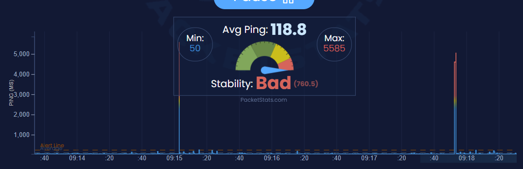

      In advance I'm an absolute noob when it comes to networking and working with pfSense in general so I'm not sure how to navigate pfSense or debug issues with any level of sophistication.
      I have a client on my network which does a lot of downloading and, when turned on, causes massive lag spikes for packets moving into my pfSense box. Typically pings to my pfSense gateway addr take around 0.3ms to return, however at random times pings take up to 200ms and sometimes even longer. For example see this paste
      So far the best lead I have is that the System Activity screen starts showing less CPU idle time, interrupt load seems to skyrocket, and a program running debug against the ruleset starts showing up and taking up massive amounts of CPU time? The interrupts seem to be the culprits here but i'm not sure what's causing them or how to find that out. In addition I couldn't figure out where/how the pfctl program was being executed which is a bit suspicious. From what I understand it's from dynamic rules being applied, however I don't think I have any dynamic rules currently? Here's a pastebin I managed to capture with all of the aforementioned issues: see this paste for a top printout showing high random load

        The ping paste : how is the device you are pining from connected to pfSense ? Wifi ? Wired ?
        If its wired, is this a classic 1 Gbit/sec connection ?
        The top paste : your pfSense is basically doing 'nothing' with its 4 cores.
        That said, on my own 4100 I've 105 processes, and you have twice as much. That's ... a bit strange. You installed and activated all pfSense packages ?
        Btw : pfctl ones in a while the firewall rules get reloaded, that's normal.
        What is the brand (type) of the NICs used ?
        @cortadalallo said in Random Massive Lag Spikes:
        I have a codel limiter working to keep traffic at a max of 85Mbit/s where my internet bandwidth is 100Mbit/s
        If a LAN devices is loading or sending something 'big' and fills up the WAN connection, less priority packages might get dropped. ICMP (ping) is a less priority protocol.
        If your traffic shaping is set up using two queues one reserved 'channel' for ICMP only, and another for the rest of the traffic, the ping latency (buffer bloat) will be gone. That doesn't mean the system will be any any faster, though.
