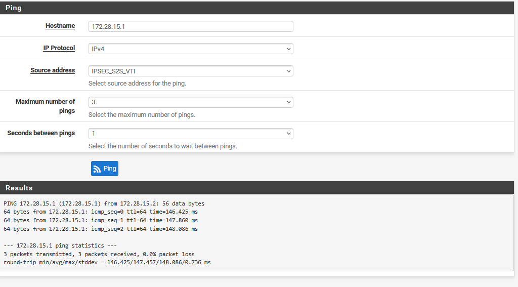

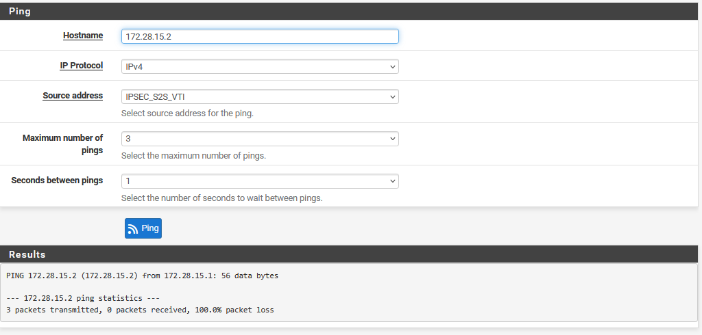

      After setting this up, Site B can ping Site A with its tunnel network address 172.28.15.1, however, Site A cannot ping Site B with its tunnel network address 172.28.15.2.
      Checking the routes and pinging on Site A:
      Checking the routes and pinging on Site B:
      I am stuck here. For the remote gateway setting on site A P1, I am using the dynamic dns fqdn for site b. I suspect this might be the problem for the routes but in that case how is this connection established?
      P2 settings are identical on both sites other than swapping the remote and local addresses.

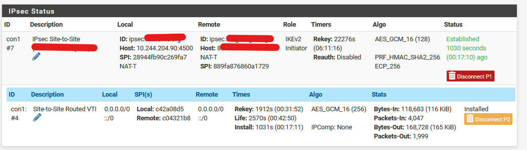

      Site B IPsec Status
      dont let the host ip address in 10.x.x.x range confuse you. This is the CGNAT WAN IP my failing ISP uses.

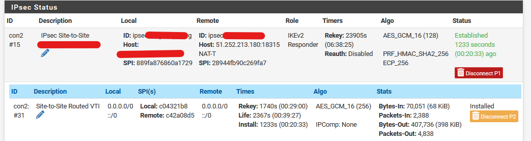

      Site A IPsec Status
      Site A Remote and Site B Host addresses do not match as expected from CGNAT.
      Anything that I can try to fix this?

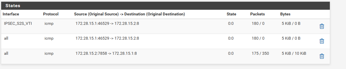

        States on Site A
        So, apparently packets are being seen by the interfaces on both sites but for some reason Site A is dropping them.
