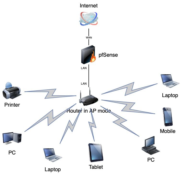

        ISP's all-in-one router/modem running in Bridge Mode -> connected to the Vault's WAN port -> Vault's LAN port connected to another router's WAN port, which is running in Access Point Mode.
        Might be helpful to share make/model/os of your LAN side router in AP mode, but sounds like a routing configuration issue in the AP.
        If I recall correctly from my DD-WRT and OpenWrt days, normally you connect the router in AP mode to it's LAN port and not the WAN port, unless you specifically bridge the WAN port to the other LAN ports.
        • N Offline
          newbieuser1 @elvisimprsntr
          @elvisimprsntr thanks for the chart! Getting rid of the ISP's Bridge Mode router and plugging the ethernet cable from the wall directly in Vault's WAN port has solved it...hopefully permanently.
