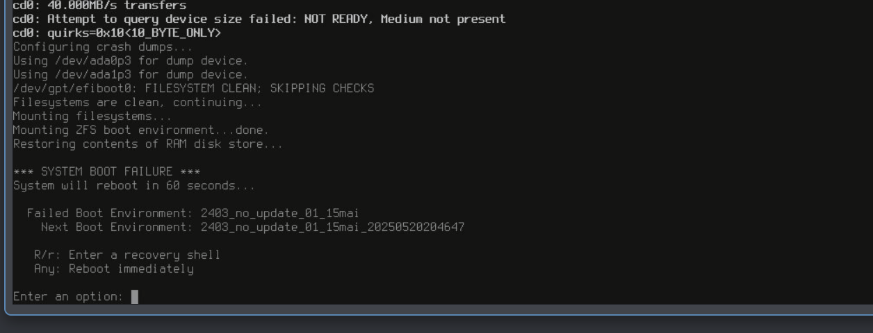

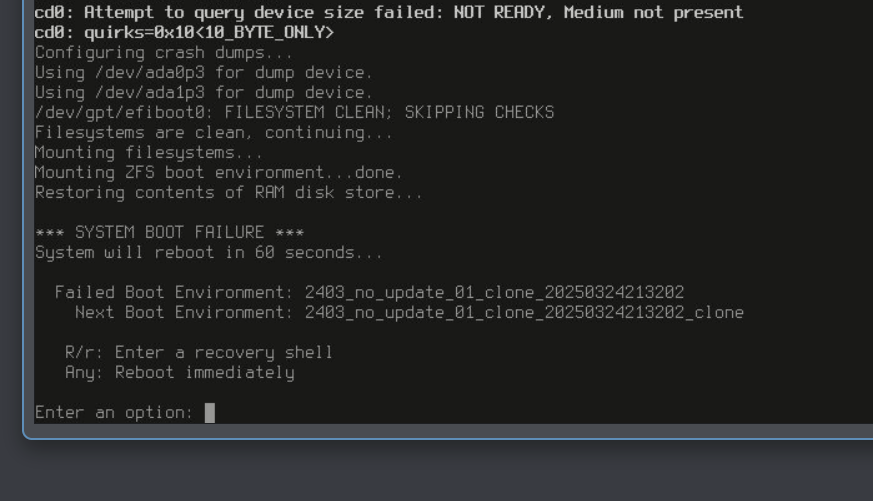

      I needed to disable the RAM disk for testing purposes, so I unchecked the corresponding option in the pfSense GUI. The system requested a reboot. Upon the next boot verification, the system offered either the previous boot environment or recovery mode.
      Can anyone confirm that? Please do clone of your working BE before testing!
      • w0wW
        w0w
        the other firewall have the same symptoms

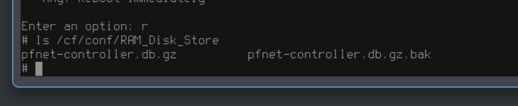

                        Any updates on this?
                        Can you inspect the contents of /cf/conf/RAM_Disk_Store from the recovery shell after a boot failure?
                        ls /cf/conf/RAM_Disk_Store should do it
                        @w0w I bet you are going to see a file pfnet-controller.db.gz in that directory

                          @cmcdonald said in Disabling the RAM disk and subsequently rebooting causes the boot environment to become unbootable.:
                          Yep and another one too, .bak
                          cmcdonaldC 1 Reply Last reply Reply Quote 1

                            @w0w said in Disabling the RAM disk and subsequently rebooting causes the boot environment to become unbootable.:
                            Thanks for verifying!
                            We've got a root cause now, and are assessing potential solutions.

                                    Sorry but something else is missing, the bug is back Immediately after update to 25.03.b.20250515.1415, ramdsik already disabled.
                                    • stephenw10S
                                      You'll need to reapply the patch to that. The fix was put it just after that was built. It will be in the next public build.
                                      w0wW 1 Reply Last reply Reply Quote 1
