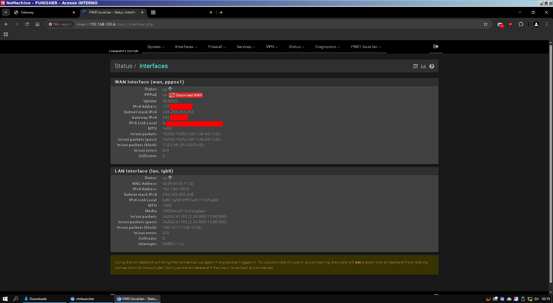

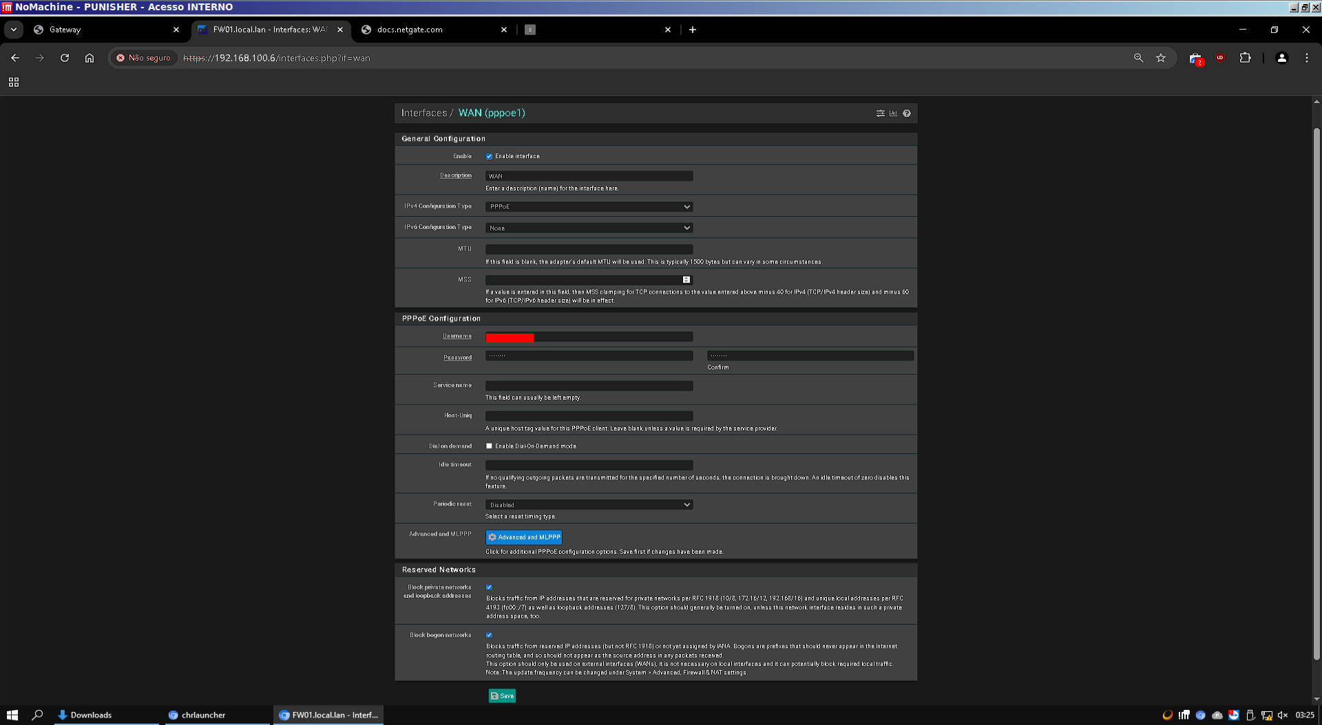

      I recently build a simple 2 interface firewall with pfSense. I have a PPoE connection on my WAN interface. The interface connects properly and the firewall receives a public IP. WAN interface is up. I can ping and reach my WAN's gateway, but can not reach the internet. Firewall rules are default that comes with PfSense. No changes have been made there. ISP modem is configured as bridge.
      I have a previous box with OpnSense. Same configuration. No problems at all. I also removed my pfSense box and connected my home router directly to the ISP modem, using PPoE on its WAN interface. Also, no problems.
      What am I doing wrong?!
      Thanks everyone.
      Captura de tela de 2025-05-06 03-19-20.png Captura de tela de 2025-05-06 03-25-01.png

            The WAN interface does indeed look good. But on LAN you set the IP to 192.168.100.6, subnet mask to 255.255.255.248 = /29 which gives you 6 usable IPs. Nothing wrong but is that on purpose?
            • Can you ping 1.1.1.1 from pfSense? And/or from a client?
            • Can you show the gateway page (redact public IPs)?
            desert_myrrhD 2 Replies Last reply Reply Quote 1

              Yeap. The LAN interface is connected to a small switch. There are only 2 computers connected through cable. I usually have a policy to restrict the network size to its minimum possible size, but I can change to its default mask. At this point, I am accepting every suggestion possible.
              No. Can't ping any IP from pfSense except the IP given to the WAN interface and its gateway IP. Computers connected also have the same behavior.
              I'm not home now. When I'm back, I will connect the pfSense box again and print the gateway page to you.

                @desert_myrrh said in WAN interface is UP / PPoE connection working / Can reach WANs Gateway / Cannot reach the internet:
                Yeap. The LAN interface is connected to a small switch. There are only 2 computers connected through cable ...At this point, I am accepting every suggestion possible.
                No reason to change the subnet mask, leave it the way it is. Just to check if you did it on purpose or if it was a typo.
                Would be interesting to know the gateway you got when on OPnsense and the ISP modem.
                Are you using pfSense CE 2.7.2 or 2.8.0-BETA?
                And on a totally unrelated note: instead of the menu 'Help' you got an entry 'FW01.local.lan'. How do you manage that, custom theme?

                        @patient0 Ok. Your suggestion nailed it. When I checked the gateway page, for some reason there was an old gateway group pointed as default.
                        The strange thing is I started all pfSense configuration from scratch before posting, reset the interfaces and configured both interfaces (LAN and WAN) from scratch using the terminal.
                        I'm not sure if I missed something or this is a bug. When you reset the interfaces using the terminal, any previous configuration should be erased. Isn't that correct or I am missing something?
