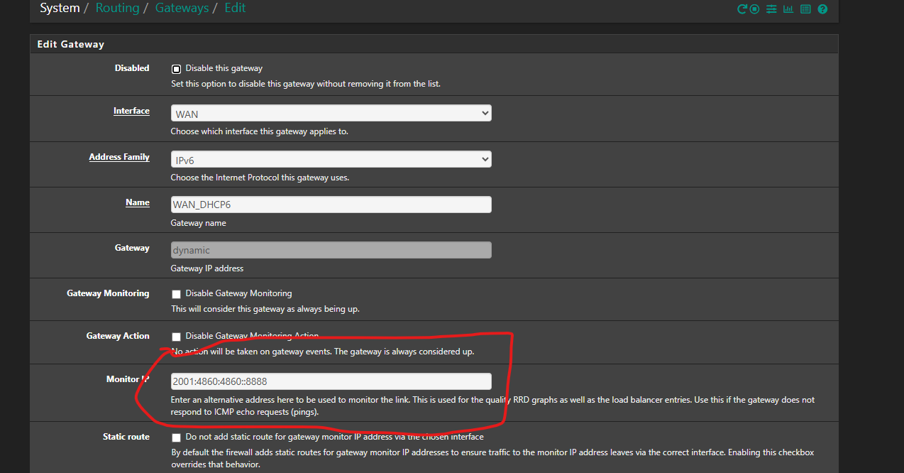

    • B Offline
      BigTulsa @GeorgePatches
      @GeorgePatches Status > Gateways, then select the related settings icon at the top right, then select the edit icon in the IPv6 gateway. Then as shown, change the monitor IP and save.

            • B Offline
              @GeorgePatches my ISP issues a /64 address to my gateway. AT&T typically issues /60 but that's only if you use their gateway. In order to make it work on mine I have to set the DHCP client as /64 and set Router Advertisement to Managed. But that limits you to one subnet getting a v6 block.
