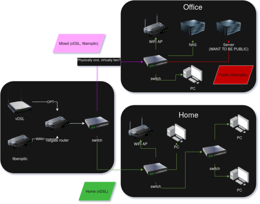

    how to separate two WAN connetions into home internet and work internet virtually

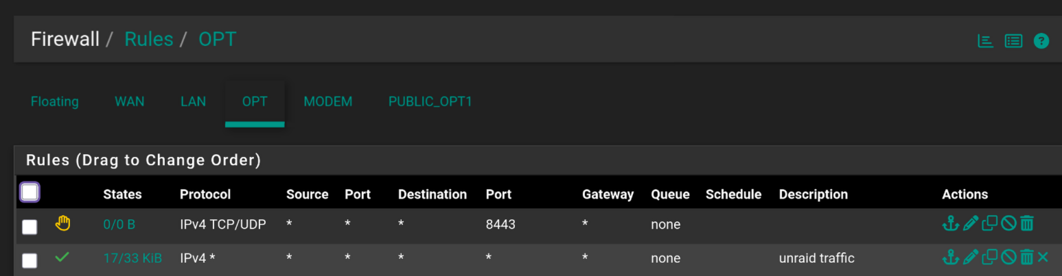

          Look at the state counters on the firewall rules you created. That shows if that are actually matching traffic.

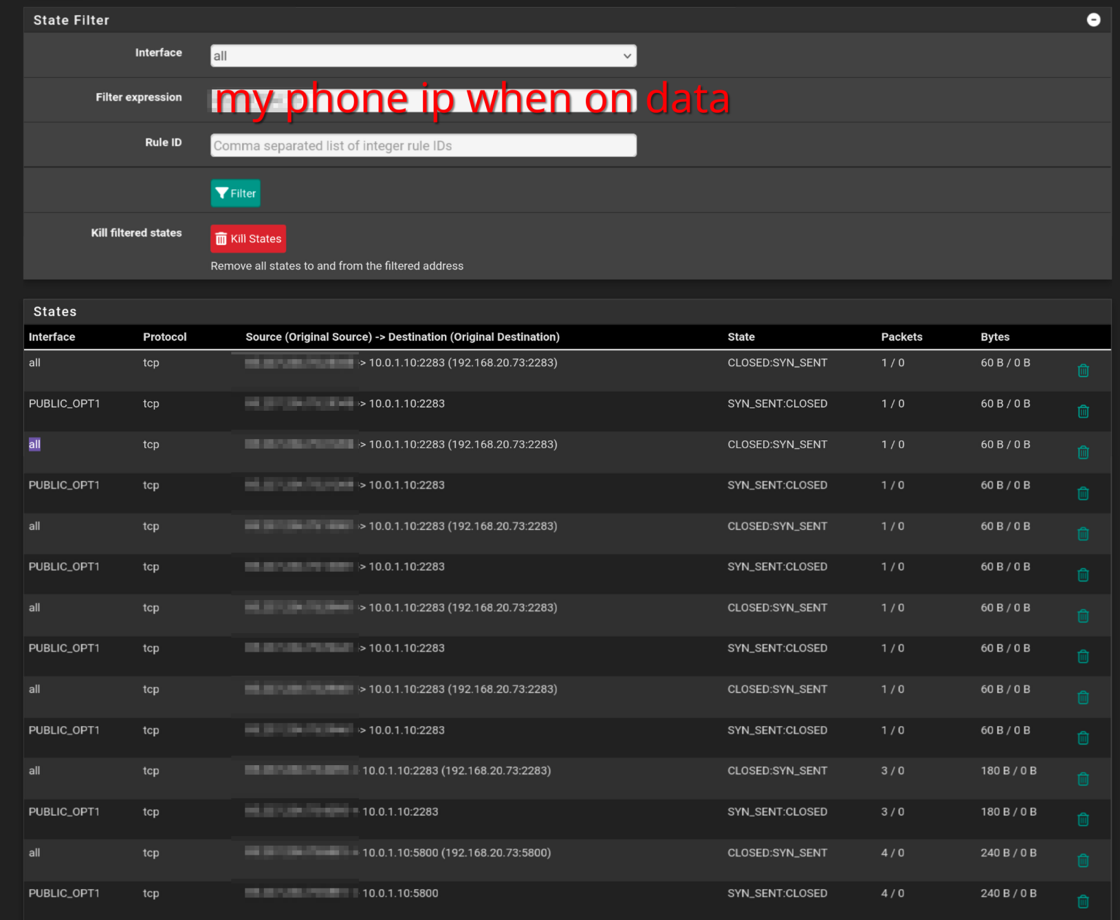

          Check the actual states in Diag > States when you are connecting from some external site. You should see the incoming state on OPT with NAT and an outgoing state on PUBLIC_OPT1.

            On my phone through data I tried connecting either {public IP}:{port}, or {domain}:{port}
            Soo I'm not sure what I see, but I see some traffic, but it's CLOSED. I assume this is because the server is not responding? From what I read online unraid doesn't have any firewall, and accepts anything coming in. The ports are to real services, and when I copy paste the destination IP to those services I see them, just not publicly.
            I guess I must be close. Any idea what this could be?

              The incoming state is shown on all interfaces and that's a problem for a non-default WAN because it need 'reply-to' tags in order to go back out the OPT.
              Do you have an interface group or floating rules passing traffic there?
              The closed state from the target really does look like it's just rejecting that traffic. A lot of devices will reject any traffic from outside their own subnet unless set to allow it specifically.

                @stephenw10 I don't have any floating rules or interface groups configured. I looked through all firewall settings, and don't see anything that would enforce something like that? Here's my entire config(stripped of certs, public IPs, passwords), maybe you'll find the offender: config-pfSense.lan-20250513135023.xml
                I'll look again into how to allow unraid to accept those connections, but I already looked before and didn't find any settings regarding firewall or public access before.

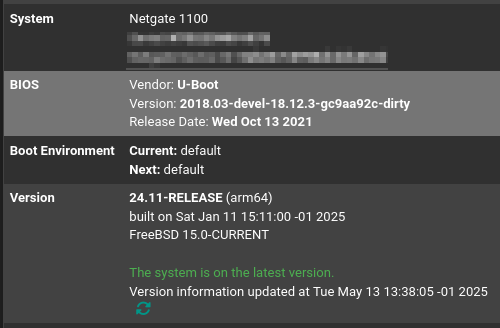

                  What pfSense version is that running?
                  • D
                    Djkáťo @stephenw10
                    @stephenw10 c9697fb7-7c5b-49d6-8f91-6d1adc28873a-image.png pfsense+ 24.11

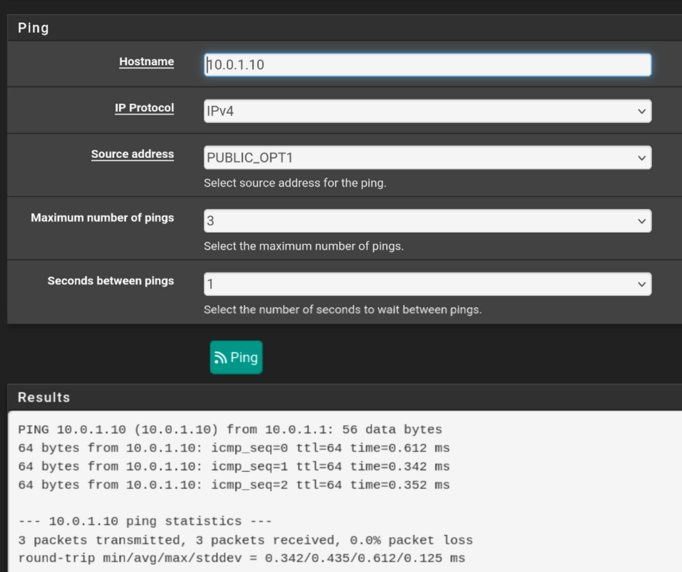

                      • stephenw10S

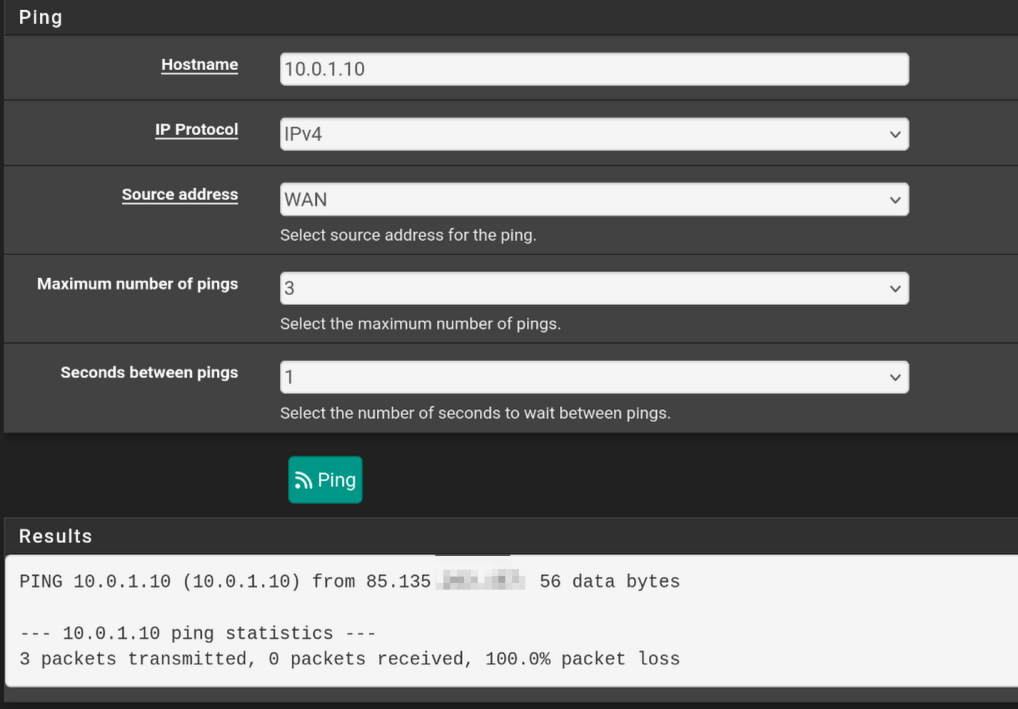

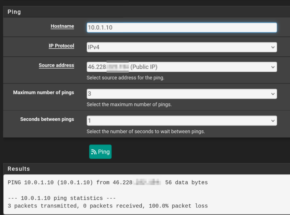

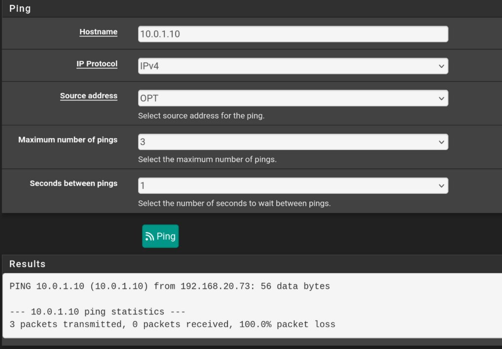

                        Is it just the inbound traffic that's failing or are you also seeing outbound not using the correct WAN?
                        Try to ping the target server from pfSense itself. It should respond.
                        Then try again but set the ping source IP to some other interface. Does it still respond?
                        • D
                          Djkáťo @stephenw10
                          • PUBLIC_OPT1(servers VLAN) > server works
                          • OPT > server doesn't work
                          • WAN > server doesn't work
                          • Public IP > server doesn't work
                          Though I'm not sure if I'm using the wrong address? The interfaces' ips are in different subnets, so I don't know if they should be able to ping.
                          My server has access to the internet, ping 1.1.1.1 from the server works. I don't really know which WAN it's using though. I assume WAN and not OPT, because the only way I got the vlan to work is by keeping default vlan untagged and add vlan 10 as tagged. How could I force only vlan 10 to be what the server has access to?

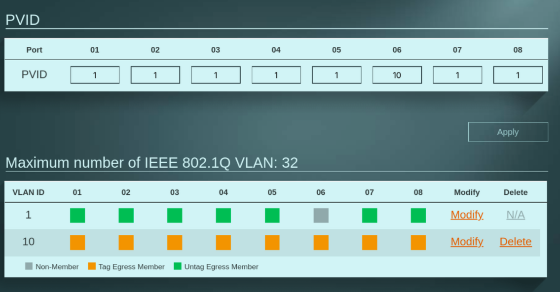

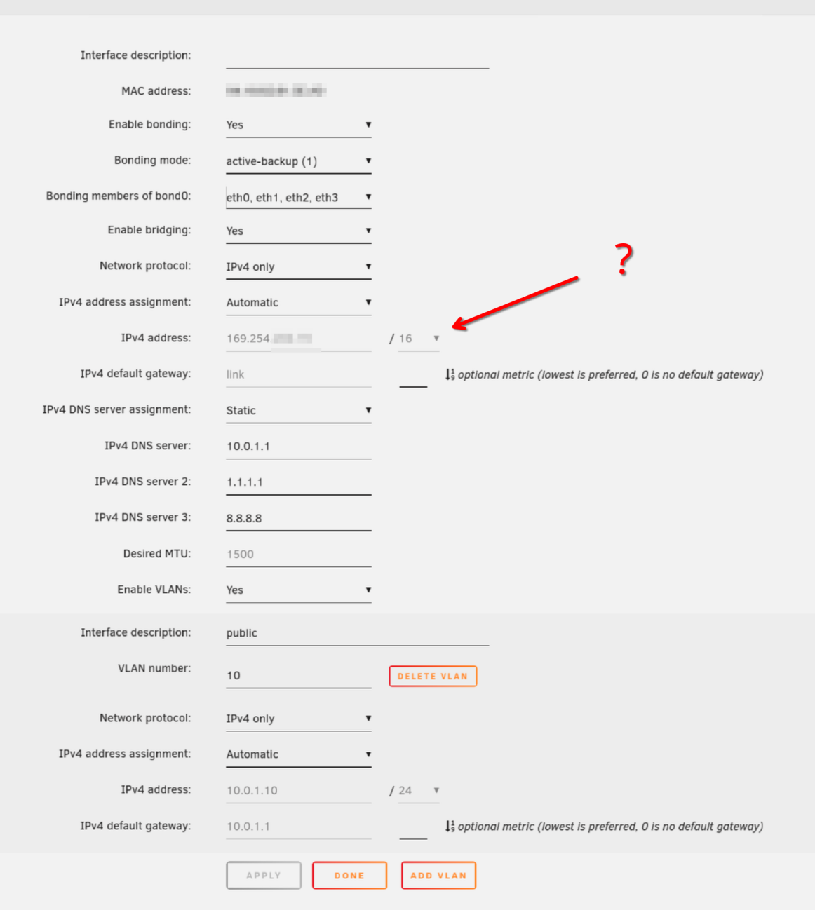

                                I have just tried isolating the server to only vlan 10 like this:
                                and after I added a firewall rule to allow LAN > PUBLIC_OPT1, I can access it on 10.0.1.10! And I bet it's only using OPT now.
                                But I wonder where this IP address is coming from. It doesn't match any of my interfaces, and DHCP on that interface is set to give out 10.0.1.0/24. Where did it get this address from?

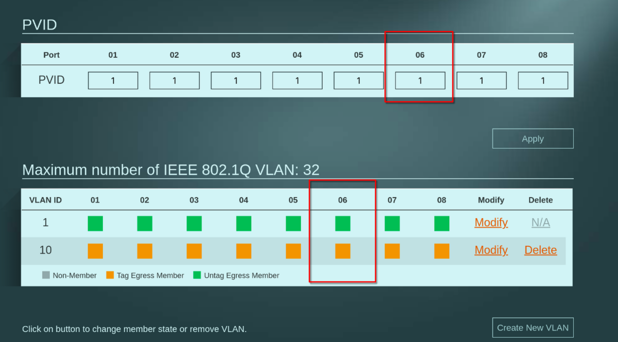

                                  Djkáťo @Djkáťo
                                  On data I can now access <domain>:2283 and <public_ip>:2283 get the docker container! I guess I just had to do that VLAN setting which forced it to use OPT, wohoo!

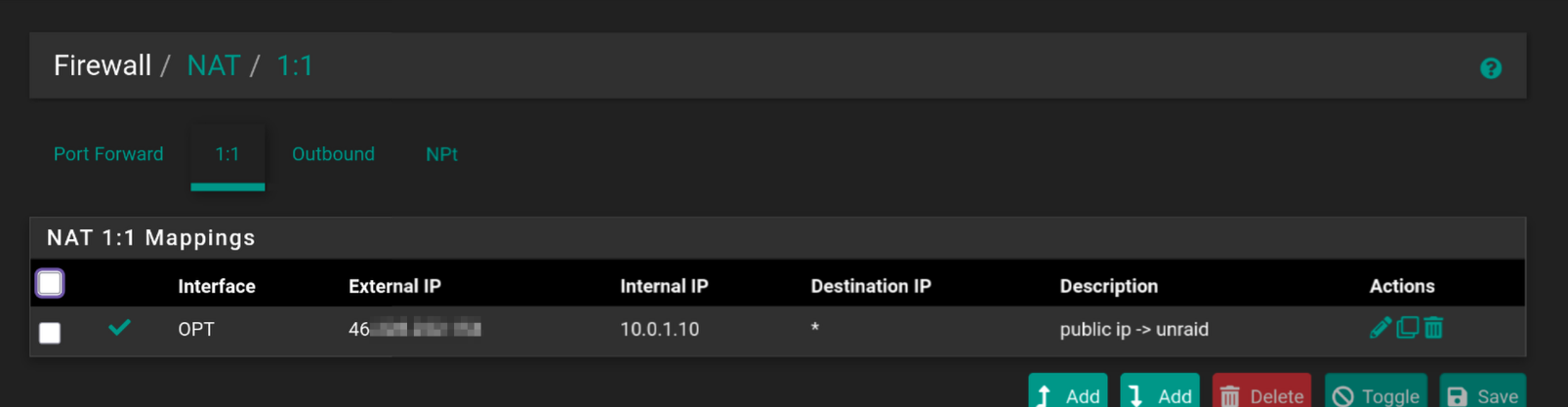

                                    Yes, in order for inbound traffic to work there it either has to pass the public IP directly to pfSense or forward all traffic to the internal IP that pfSense is using.
                                    Now it looks like it might be configured to forward all traffic because when you tested from an external location you could see states incoming from your real IP. So you may not need to do anything. Though it's almost always better to get the public IP on pfSense directly if you can.
