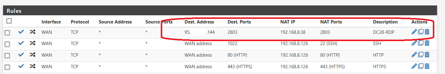

The rule is anyone connecting to the specied VIP on port 2803, forward it to the local IP (192.168.8.38) of windows machine on port 2803

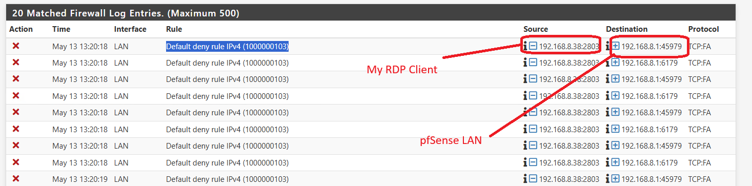

Looking at the firewall logs, I can see RDP traffic coming from my laptop on the internet and being forwarded to the RDP client successfully
- However, the logs also show that the return packets from RDP client to pfSense are being blocked on the LAN interface (Default deny rule IPv4 (1000000103)
I have setup the NAT with reflection (Pure NAT)
- pfSense created the corresponding WAN rule for it too

@TheCalvinator those are all fin,ack - ie that rdp box sending back to the pfsense IP, which unless your doing source natting shouldn't be happening. Even if was going to send FA it should be to the IP of the device wanting to connect.. Something on the internet I take it since your port forwarding stuff that hits your wan.
That return traffic should of really been to your 209.x address. Unless you source natted it, ie outbound nat on your lan so the rdp traffic sent to 2803 looked like it came from pfsense IP on your lan I assume (that 192.168.8.1 address)
But either way, your port forward works and the rdp box on 192.168.8.38 sent back a FA..
I would guess those are just multiple FA being sent, even after pfsense closed the state. Or you have asymmetrical traffic flow - but if that was the cause you really should of seen SA (syn,ack) being blocked because lack of state.
If pfsense has no state open to allow the traffic, then yes it would be blocked by the default deny.. Or if there was a state but the device continues to see traffic after the state was closed then yeah that traffic would be closed.
A FA is that 192.168.8.38 saying I am done with this conversation. So its not pfsense causing a problem with your port forward.

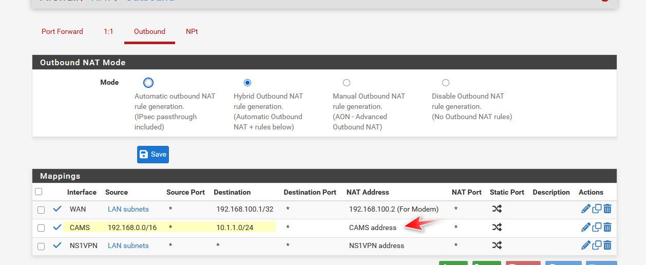

@TheCalvinator what do you have in your outbound nat - do you have something setup for outbound on your lan interface? That would nat your traffic so it looks like it came from pfsense IP on that interface.
You might even want that so you don't have to alter firewall rules on the box your rdping too.. It would think the client is on its local 192.168.8 network.
example: here I nat traffic going to my cams network (10.1.1/24) so it looks like it comes from pfsense IP on that cams network.. The cameras on that network use the nvr as their gateway, no pfsense - so if I didn't source nat the traffic they wouldn't send the traffic back to pfsense, they would send it to their gateway. Which wouldn't work.
