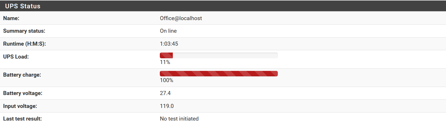

      UPS status is functional on the firewall:

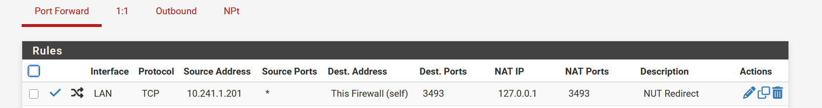

      I am using a port forward:
      b1830624-dd52-4488-9e72-5f689a075020-image.png cb76e7f0-ee1c-499d-84f9-39d87e02b99c-image.png
      And there is a FW rule to match:

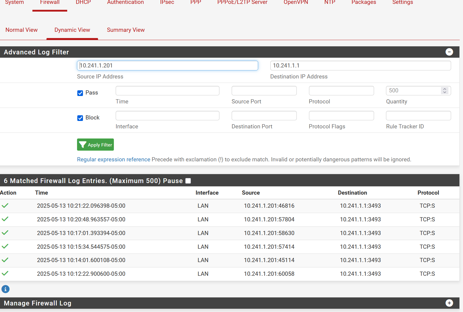

      When I attempt to connect from a remote host I timeout even though I see a stateful firewall connection:
      Prior to upgrading I did not have the port forward and I just added the LISTENER statement and everything worked perfectly. Since the upgrade I have made every change I could find and nothing allows the upsc on the remote device to make the connection and pull the data.

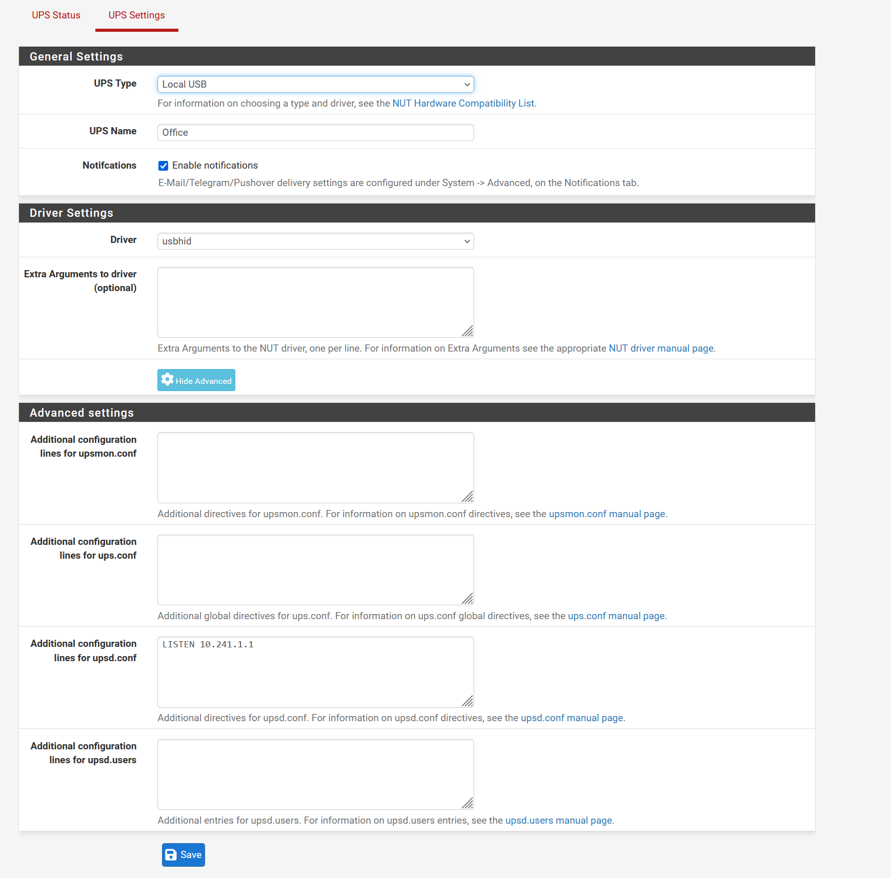

        @jeffry-maynard You did not post sufficient information: You didn't show your pfSense NUT configuration (the NUT config files are all automatically generated by the pfSense NUT package), didn't show how you are invoking upsc, and didn't say what if any error you are receiving from upsc.
        That said, I suspect that your problem is that you do not have a username/password set up in your configuration to support upsc. Look in Services / UPS / Settings / Advanced settings / Additional configuration lines for upsd.users, and add appropriate configuration.
        BTW, don't just look in upsd.users and copy the admin or local-monitor username/passwords. These passwords are all automatically set to random values that change.
        Also of note is that you have stuff in Advanced settings / Additional configuration lines for upsd.conf that you are not using and should remove.

          This is very odd to me since I see the connection being made in the firewall rules provided in the last message:
          83b443e3-fce8-44f8-ae5e-d7951a3c8d67-1747155362751-e89940ff-5884-4bcc-95e9-6b251cce4605-image.png

            @jeffry-maynard said in NUT Remote Access Stopped Working After Migration from CW 2.7.2 to 2.8.0-BETA:
            If I hear you correctly, your stating that I should remove the LISTEN directive in Advanced settings / Additional configuration lines for upsd.conf.
            You should either remove the LISTEN directive, or remove the port forward. You cannot do both. See the instructions on remote access here. I've tested the port forwarding variant with 25.03, which is very close to 2.8.0, and it works as expected.
            NB: When specifying the Destination Address, either with port forwarding or with a firewall rule, you probably want to use "LAN address" rather than "This Firewall (self)". You might also want to change the Source Address to Any until you have it working.
